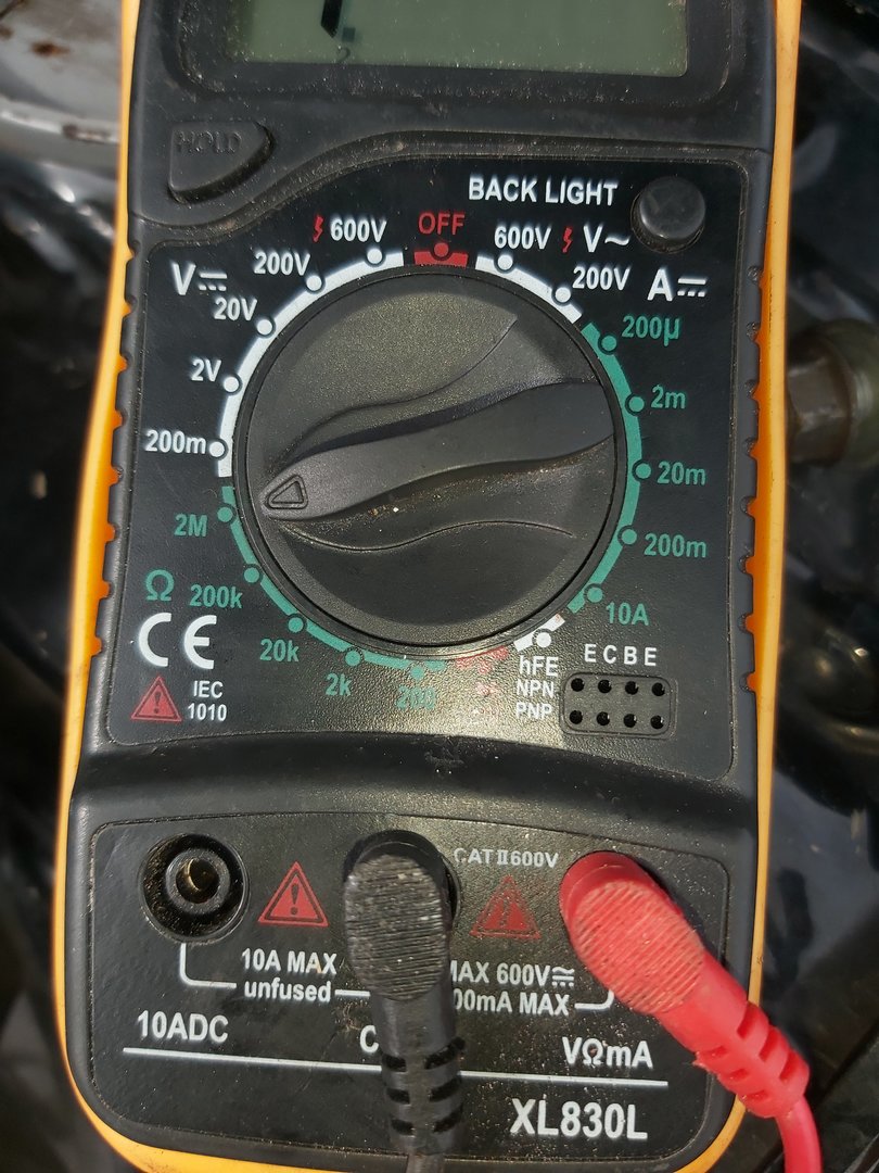

got a pic of your multimeter showing what it's set to?
Just dont understand how the leading is showing number but trailing shows nothing, ive tried it on lowrr ohms setting and no difference
SignUp Now!got a pic of your multimeter showing what it's set to?
Reads 01.5 on a-b and nothing at all on a-tSo what do you get if you turn it down? Just keep lowering it until you get a reading higher than 0.
Nothing at all like not even fluctuaton , as if i hadnt even touched it.Nothing at all being 0 or no reading showing no continuity? Haha.
What setting was it on to get 01.5?
Setting is on the 200 straight down to get that 01.5
So if both trailing are above 1 they need replacing ?Ok so that's correct for the A - T reading, you want it to have no continuity.
For A - B on 200 you'd want less than 1 so it's above the specified resistance being 1.5. Sometimes if you leave it hooked up a few seconds they drop a bit.
Yes they are out of Mazda's acceptable spec if above 1 ohm.So if both trailing are above 1 they need replacing ?
As ive tested them both on ab and they are both higher
Thankyou for your helpYes they are out of Mazda's acceptable spec if above 1 ohm.
Thanks for the offer but il hopefully just buy a new set and bang them on, to be fair i expect these have been on there since new so could do with replacingNo probs. want to borrow my spare set to test as you're local?
