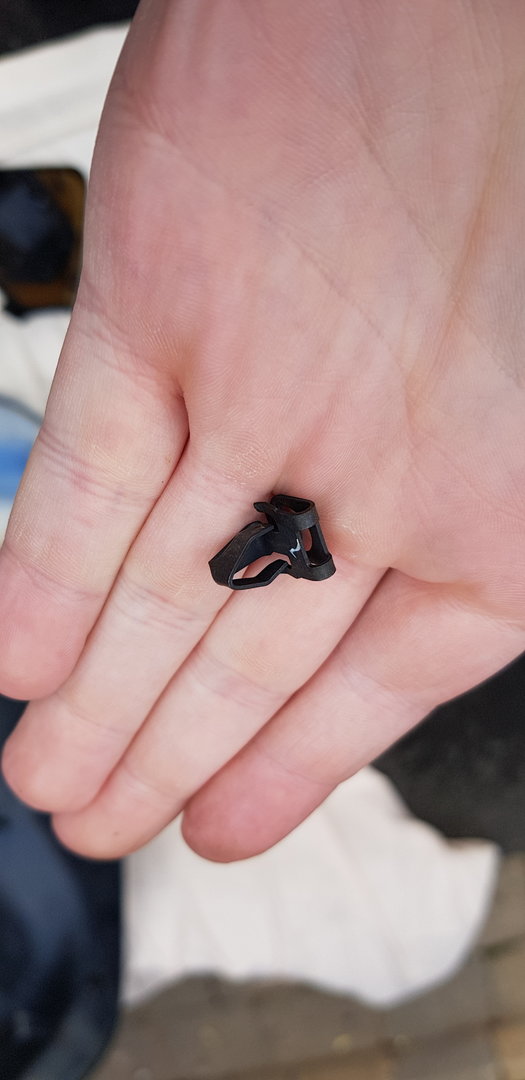

On a similar note, and to save starting a new thread, does anyone know where I can get more of the interior fixings like the one in the attached image?
