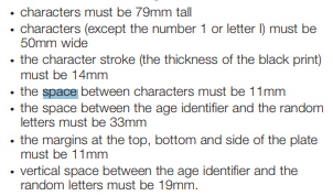

That's not for Japanese imports
Letter sizing still gotta be right though, just the size of the plate is different.
you still need gaps on groups of letters if thats what it is on V5
From what i have read, you can use motorbike sized lettering IF your import bumper does not have the provision for a regular sized plate.
