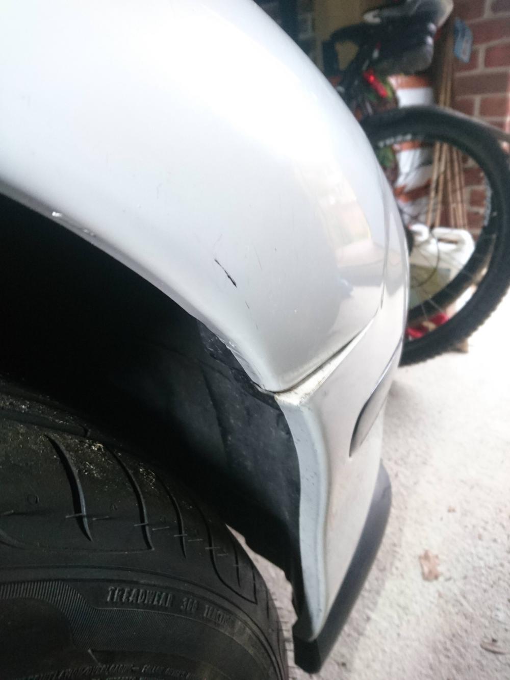

G Gunnytron Well-known member Joined Apr 7, 2018 Messages 397 Apr 7, 2018 #1 Can anyone tell me what type of fastener I need to join the front bumper to the wing? Ebay if possible. I also need to know what clips hold the wheel arch liner to the wing. Ta
JoeLanger Official FDOC Trackday Ballast Moderator Event Organiser Joined Jan 7, 2018 Messages 2,585 Apr 8, 2018 #2 There's a self tapper that goes inside, behind the arch liner. I couldn't find my clips so I used M5 rivnuts instead
jack.am Well-known member Joined Jan 9, 2018 Messages 1,058 Apr 8, 2018 #3 I use castle nuts and m6 bolts for the wing/bumper
Paulm Well-known member Joined Jan 23, 2018 Messages 1,006 Apr 8, 2018 #4 I use m6 stainless bolts and nylock nuts, cheap enough from toolstation
G Gunnytron Well-known member Joined Apr 7, 2018 Messages 397 Jul 22, 2018 #5 JoeLanger said: There's a self tapper that goes inside, behind the arch liner. I couldn't find my clips so I used M5 rivnuts instead Click to expand... M5 nutserts did the job nicely, thanks.
