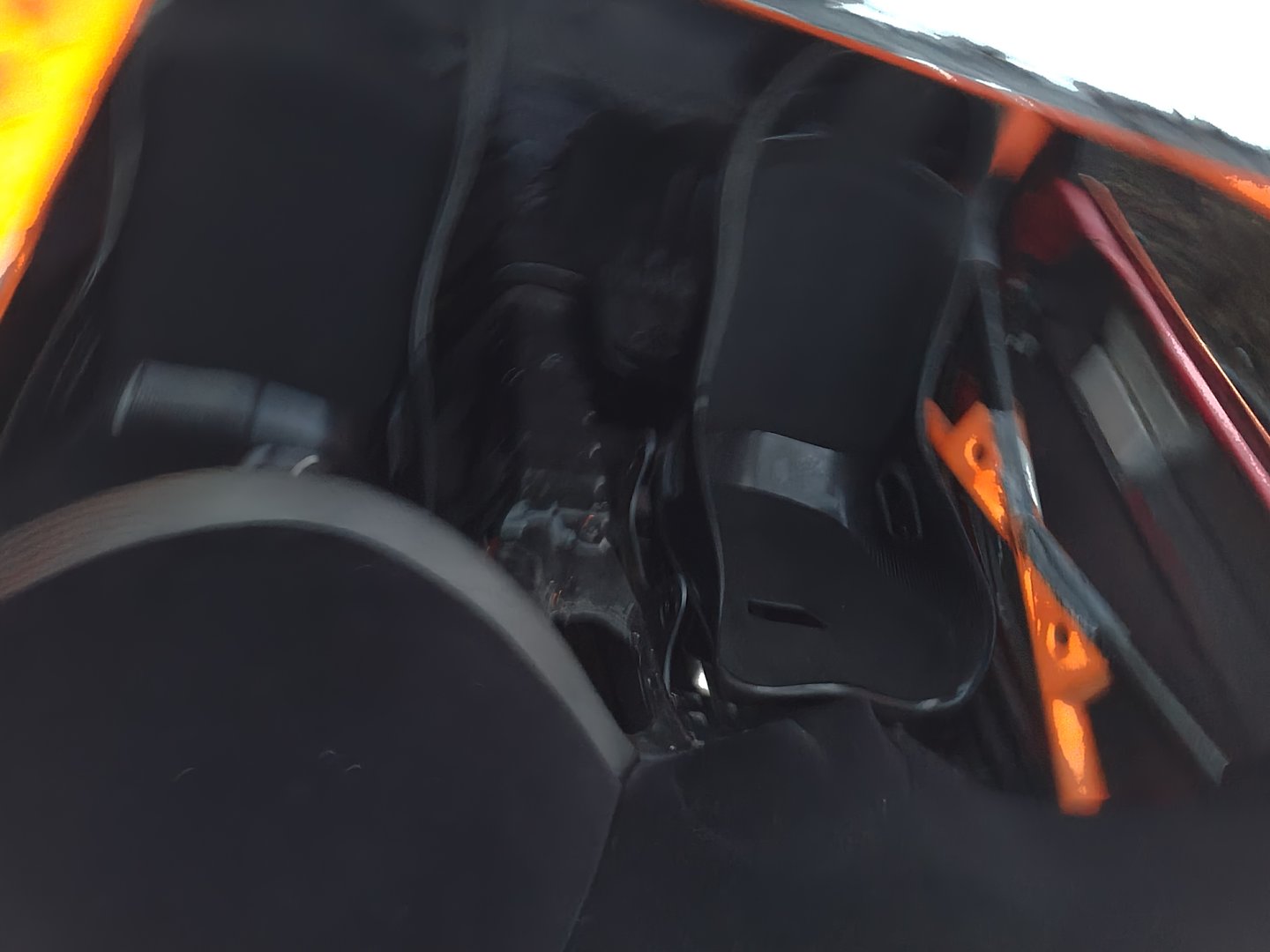

I have the B6-40 seats and they fit in mine, I'd say with loads of spare space.
I do have a fully stripped interior and roll car 'X' in the doors, but still loads of room, so I would guess in a carpeted, more standard interior they would still be fine

Got any pics ? - which mounts did you use ?
it seems the only issue might be the tranny tunnel in a standard rhd car

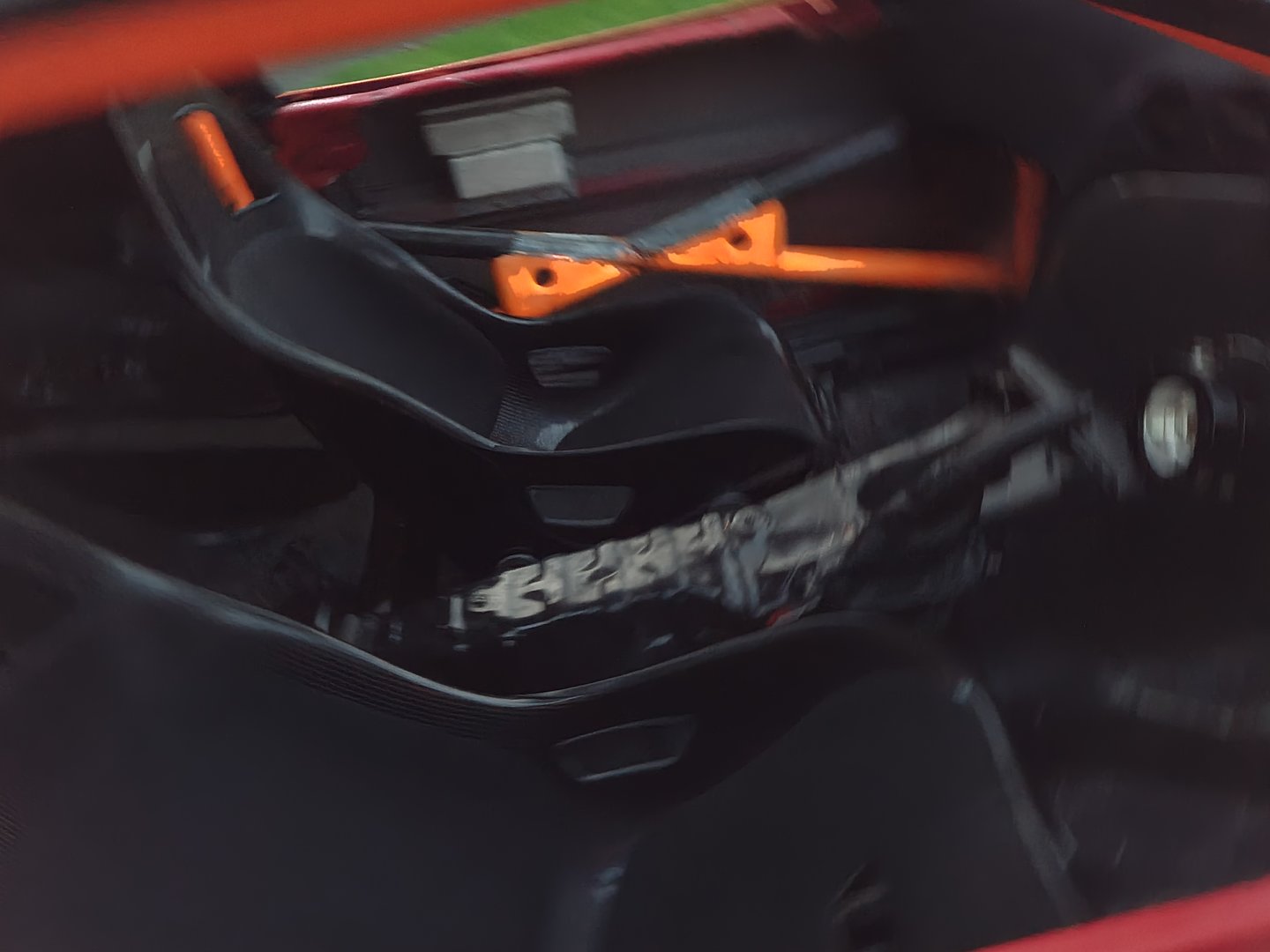

I only have a couple, and they are a bit blurry/poor quality because I was rushing, but there should be no problems with the tranny tunnel.

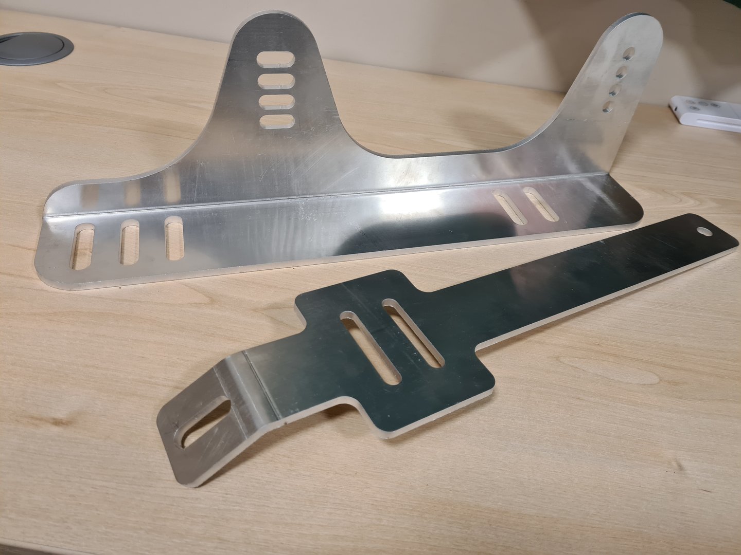

I have some low aluminium mounts, could try and find where I got them from if needed.
Ignore the state of the car in general, it's being sorted at the minute 😂

They look really smart - Mine should arrive tomorrow!
I think i've seen those low profile mounts on eBay from a guy who refurbs the brake calipers

Yeah that's right, I got them on eBay a while ago, pretty sure he has some hi spec rear brakes listed too.

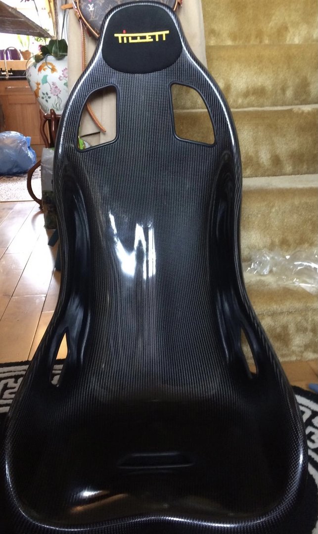

went for the 44 - not the xl pair but the 40mm with the edges left on - looks really nice
I didn’t get the cushions with it as they seemed expensive for a piece of foam so I’ll get them made locally
Can’t fault the supply too - less than 24 hours and it arrived !

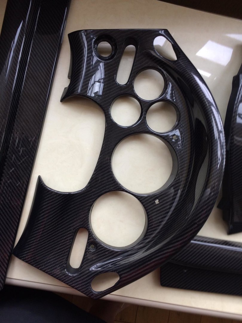

also they match well the carbon dash parts - same weave !
