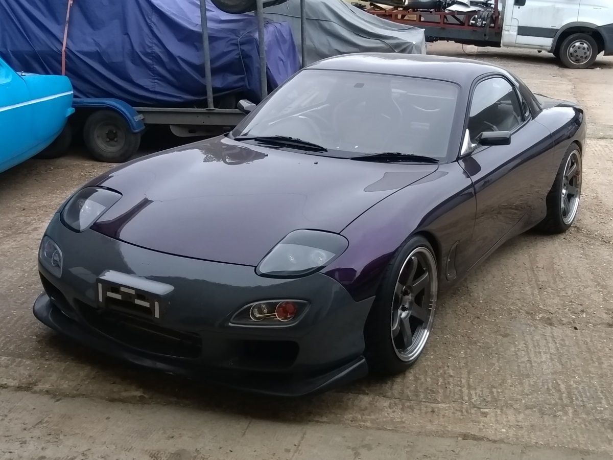

This is mine:
Stock Body with rolled arches
VOLK TE37SL 18 x 9.5 ET22
245/35/18 Rear Tyres
225/40/18 Front Tyres
1 Degree Camber on the front
1.3 Degrees Camber on the rear

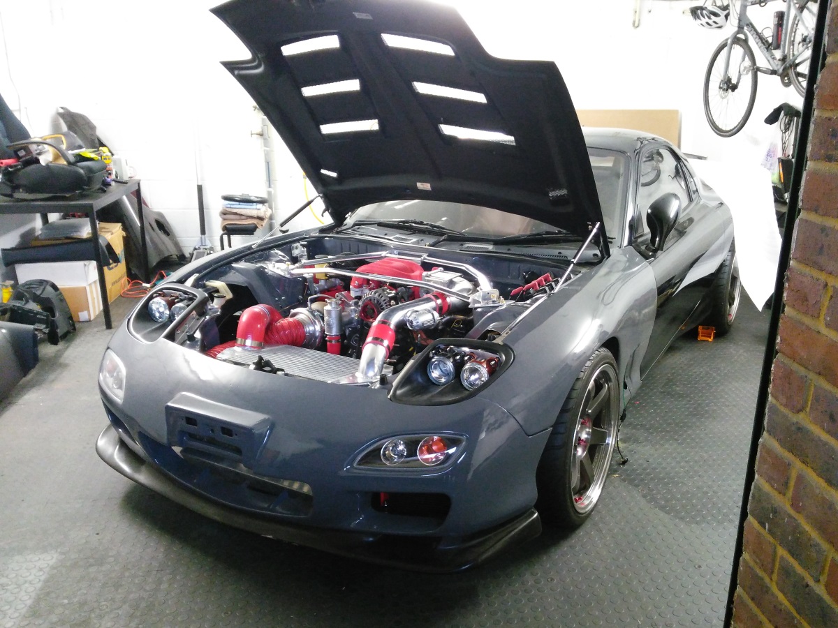

Just to add to your question on whether a square tyre setup would work:
In this picture I had 245/35/18 tyres on the front. The front wings are Shine Auto stock look +20mm which I believe is the same as the FEED front wings and they fitted fine.
