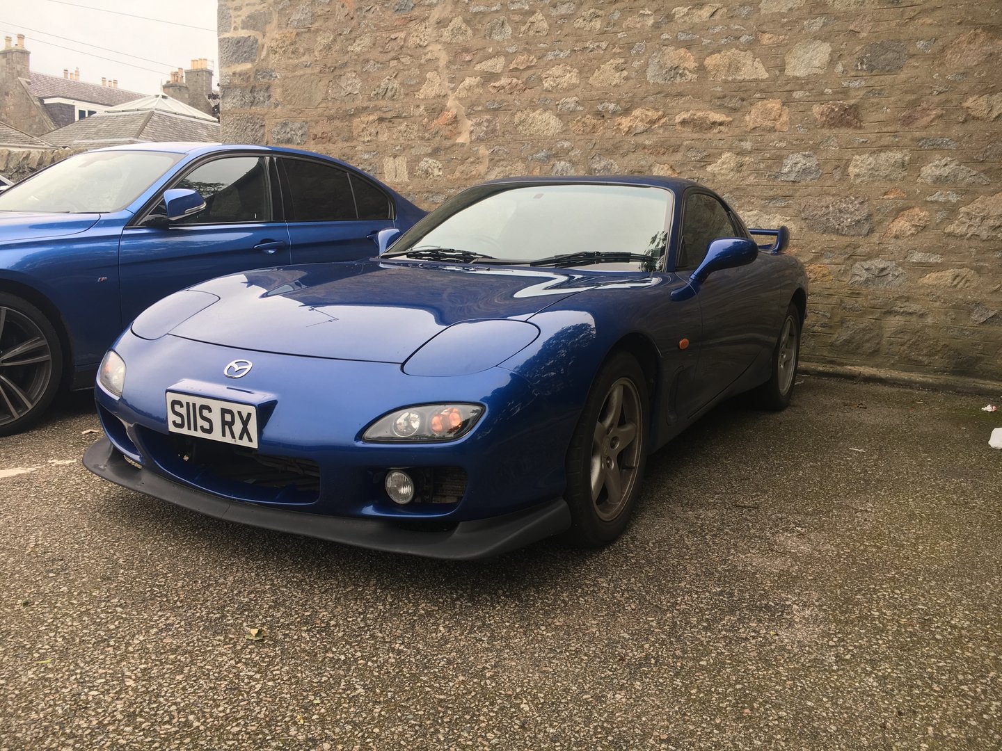

My FD is absolutely mint at the moment with no signs of rust in the arches at all. I have had a few mx5 though so I know how quickly that can change. Is there a recommended way to prevent any rust starting? Gravetex or underseal under the liners?
The car is kept garaged and not used in the winter which should help.
Thoughts please!
