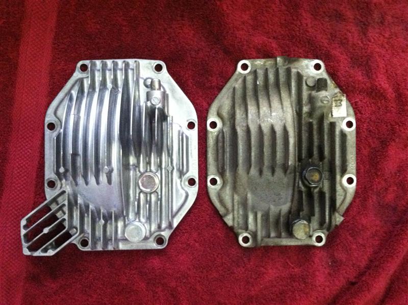

There a couple of options for the diff rear cover:
1) The RX8 one with additional fins for cooling shown below (left) against the stock RX7 one (right):

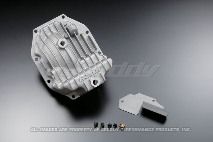

2) The Greddy one that allows extra oil capacity, and also has take offs for an external cooler should you need it:
