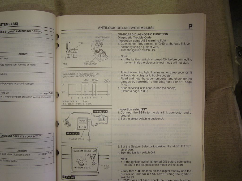

1) Disconnect the battery for about 30 seconds to discharge the airbag system's "back-up power supply" capacitor. This will clear old PCME stored faults. Reconnect the battery.
2) Place a jumper wire (a paper clip will do) between the "TEN" and "GND" terminals of the Diagnostic Connector.
(Cars with no 'CEL') connect the positive end of the LED, with a 500 ohm resistor in series to the 'B+' terminal. the negative side of the LED should go to the 'FEN' terminal. Now use the LED as your CEL. I used some pre-wired LEDs from ebay (5 for 99p) that then didn't need the resistor in the line.
3) If the engine is known to run, however badly, start the engine and run it for about a minute. If it will not start, attempt to start it for a few seconds. Next, with the engine off, turn the ignition key to the "ON" position.
4) Observe the CEL. If there are no current stored trouble codes, the CEL will turn on for 2-3 seconds and then go off. If there are stored codes, the CEL will display flashing code(s) identifying the trouble area. (If the CEL stays on, possibly the jumper wire or paper clip is not making a good connection.)
The flashes are read as follows:
1) A break between repeats of the code(s) lasts 4.0 seconds. During this time the CEL will be off.
2) The code(s) can display "tens" digits and "ones" digits. A "tens" digit is 1.2 seconds long. A "ones" digit is 0.4 seconds long. If the code number is greater than "10, the "tens" digit(s) will display first, followed by a 1.6 second break, followed by the "ones" digit(s). Example: Code #34, an Idle Air Control Valve electrical fault, would be displayed as three 1.2 second flashes followed by a 1.6 second break, followed by four 0.4 second flashes, followed by a 4.0 second break, followed by a repeat.
3) If more than one failure is present, the code numbers will be indicated in numerical order.
