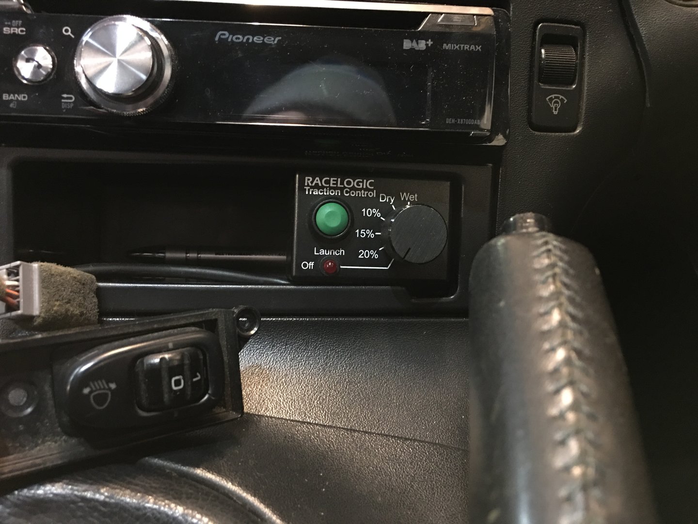

Have you got a neat way of mounting the adjuster? I stuck mine to the pocket underneath the stereo temporarily while I tested it and its still there 6 years later! I was going to dissect the adjuster and mount it recessed in the dash, but couldn't be sure it was going to fit before drilling the hole.

The adjuster fits snugly in the cubbyhole for now, but I don't really like it and have had three different ideas for it, as the circuit inside the adjuster is pretty simple, each selection just changes the resistance.
Modify or remake the cubbyhole to include the adjuster.
New adjuster mounted on the steering wheel, as I have two spare connections steering wheel connector, but I don't know how the resistance will change as the steering wheel is rotated.
Re-purpose the RX7 headlight level switch to replace the selector, but it only has 4 positions instead of the selectors 6. The RX7 adjuster seems to be a standard size item, secured in a RX7 specific housing for the RX7 switch profile. I was thinking of looking into the possibility of using another headlight adjuster switch with more positions, but can't seem to find many other similar adjusters with 6 positions

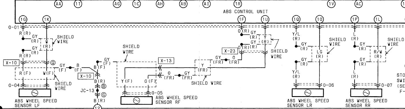

Hi All, I'm looking to wire all 4 wheel speed sensors into my Link G4X on my 99' FD. Can someone tell me the wire colours for each wheel speed sensor? Hoping to utilise the traction control and also use it for 3D launch control setup. Thanks
You can see the colours here. This is the abs unit in the rear wing. If you haven't already, download the wiring diagrams and service manuals. FYI the wiring my vary depending on year. IIRC the abs system changed around 94/95.
Hi, Very belated response but finally got round to trying it out but couldn't get it working. I didn't seem to pick anything up on the ECU input, even at higher speeds.
I spliced into the white wire for the LF wheel speed and connected it to my Digital Input and setup the ECU accordingly. When logging no voltage or pulses were recorded. Is this is the correct wire?
I am now looking into a VR to Hall effect converter to give me a 5V signal which the ECU should pick up. For this I assume I will use the Red and White wires from the LF, does that sound right? The red and white wires were twisted together making me think they are the correct wires. Any advice would be appreciated.
Thanks
Colours may be differnt on the JDM drawings
It should pick up something. Try measuring voltage with your meter and rotate the wheel. Should be able to see a short spike on every tooth
