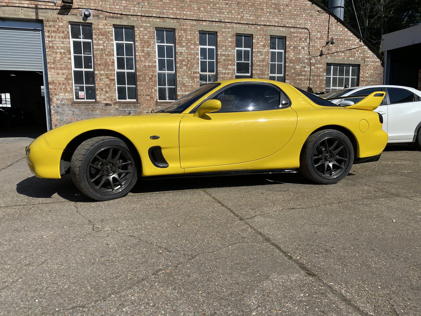

Damn dude. I spent months searching for a yellow FD and couldn’t find one I liked before giving up and buying my blue one. I don’t have the time, skills or patience to strip down and respray!
It looks incredible, I hope the rest of the build goes smoothly!
What shop did the paint? I’m not far from corby and looking for some paint and repair soon

Tbh it’s easier than you think to strip, I stripped out all the interior and had them do the inside but you don’t need to go that far, just do the outside and door shuts and you could prep it yourself like I did to save labour cost.

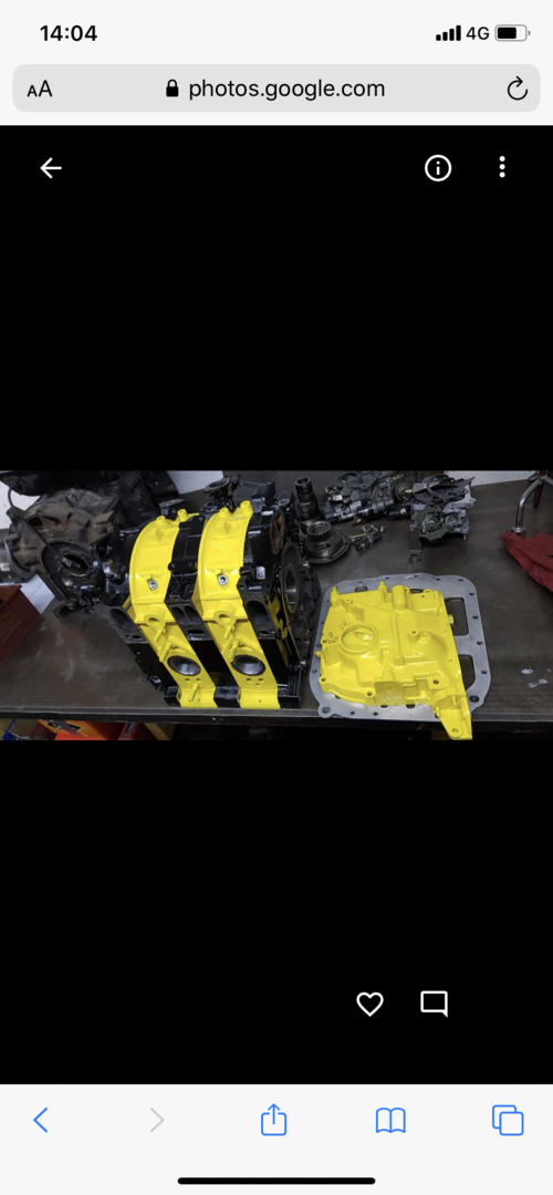

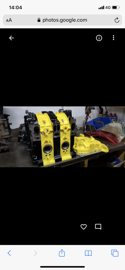

Only a minor update, Chris has sent me a picture of the engine which I think looks sweet. My turbo is here and just waiting to collect from a friend on the American base. Car is being flat and polished now and is looking sweet, a new windscreen should be here today.

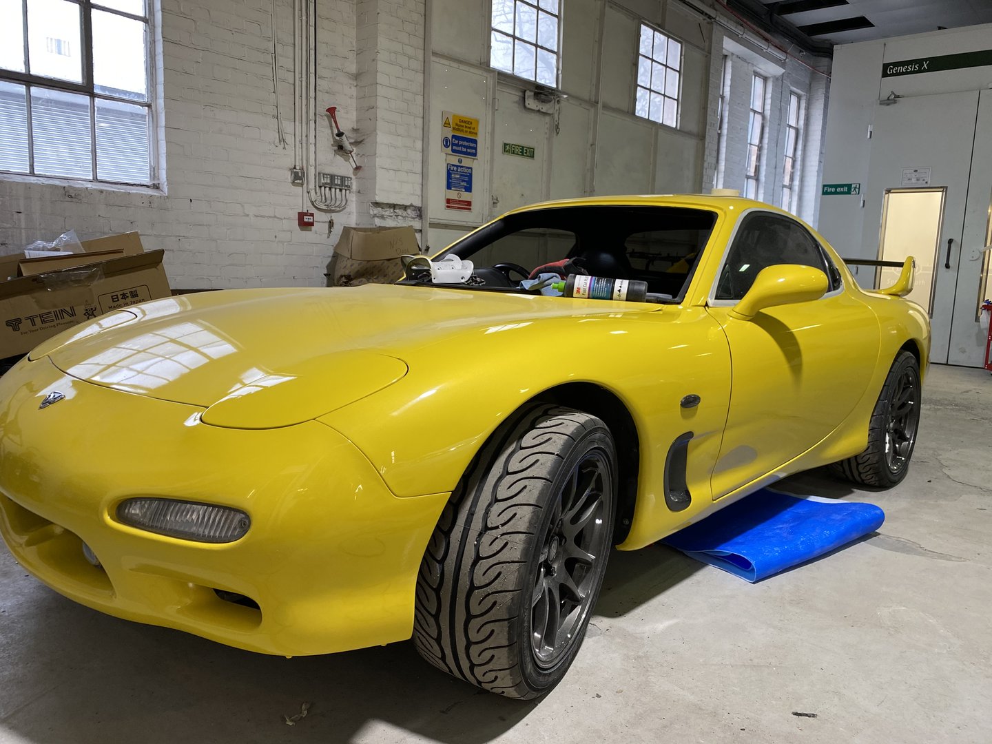

Also decided to remove air suspension as I’ve changed what I want to do with the car now. So I’ve fitted some Tein flex z. Anybody got a show car that wants air ride?

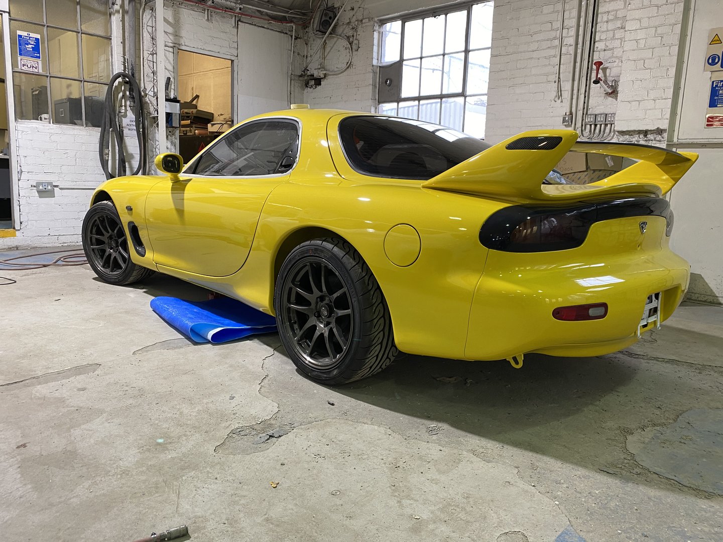

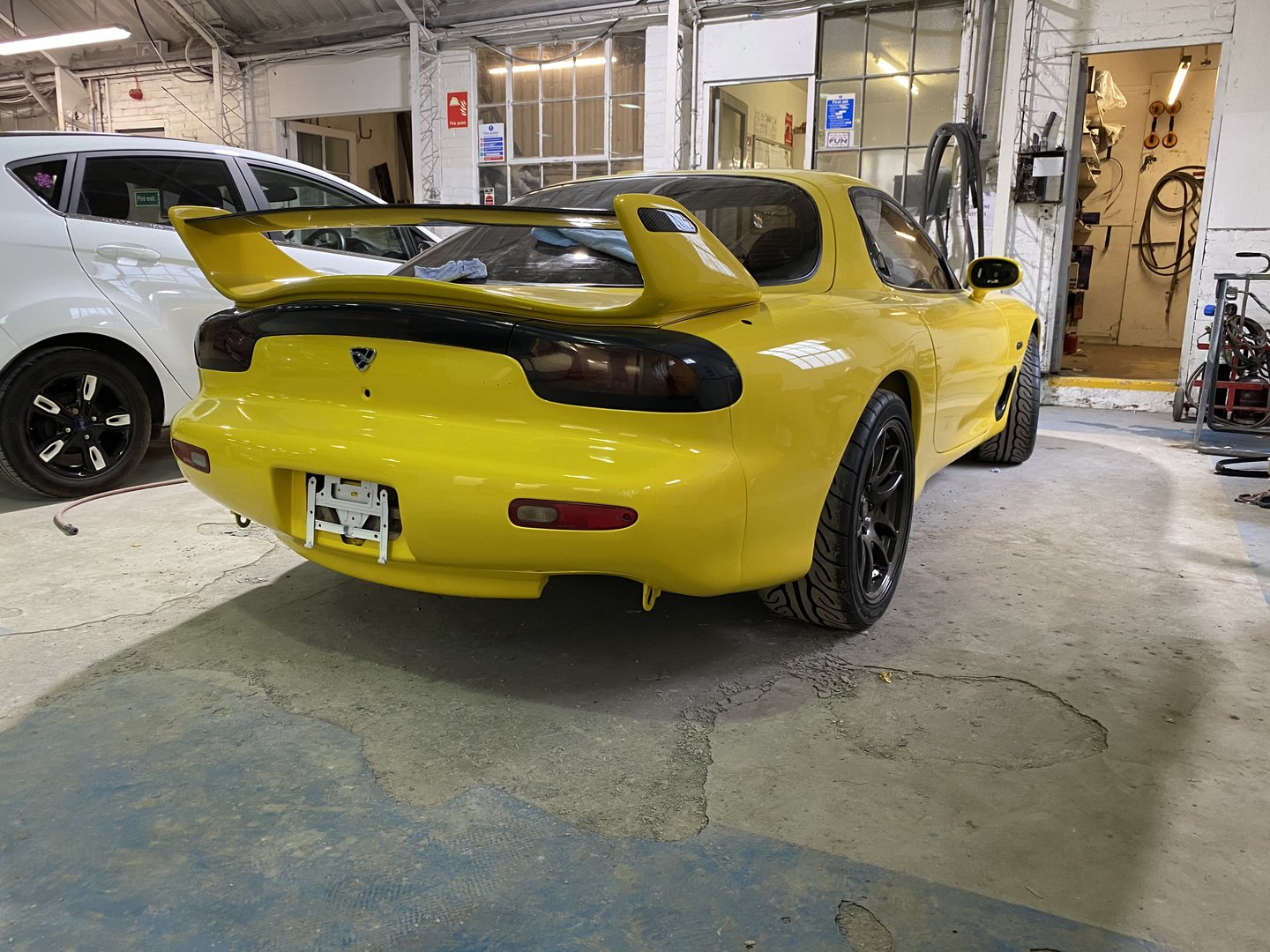

Skirts on
Diffuser on (not finished)
Suspension sitting high so it can get on a trailer. But here she is. Unfortunately with the covid virus I think the car will be delayed.
Here she is anyway. Feel like I need a carbon bonnet.
btw it hasn’t been cleaned here but I’ve now cleaned all the glass and the inside
