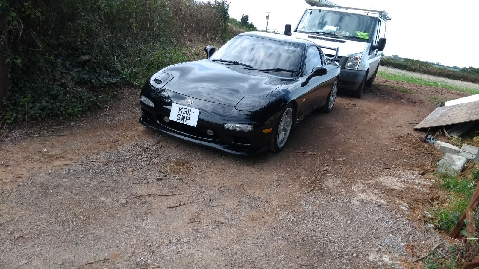

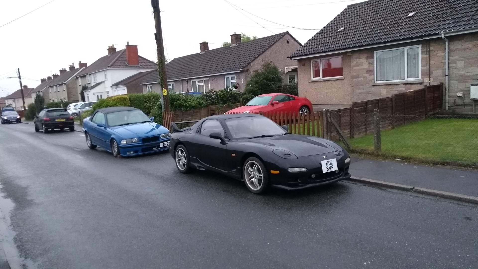

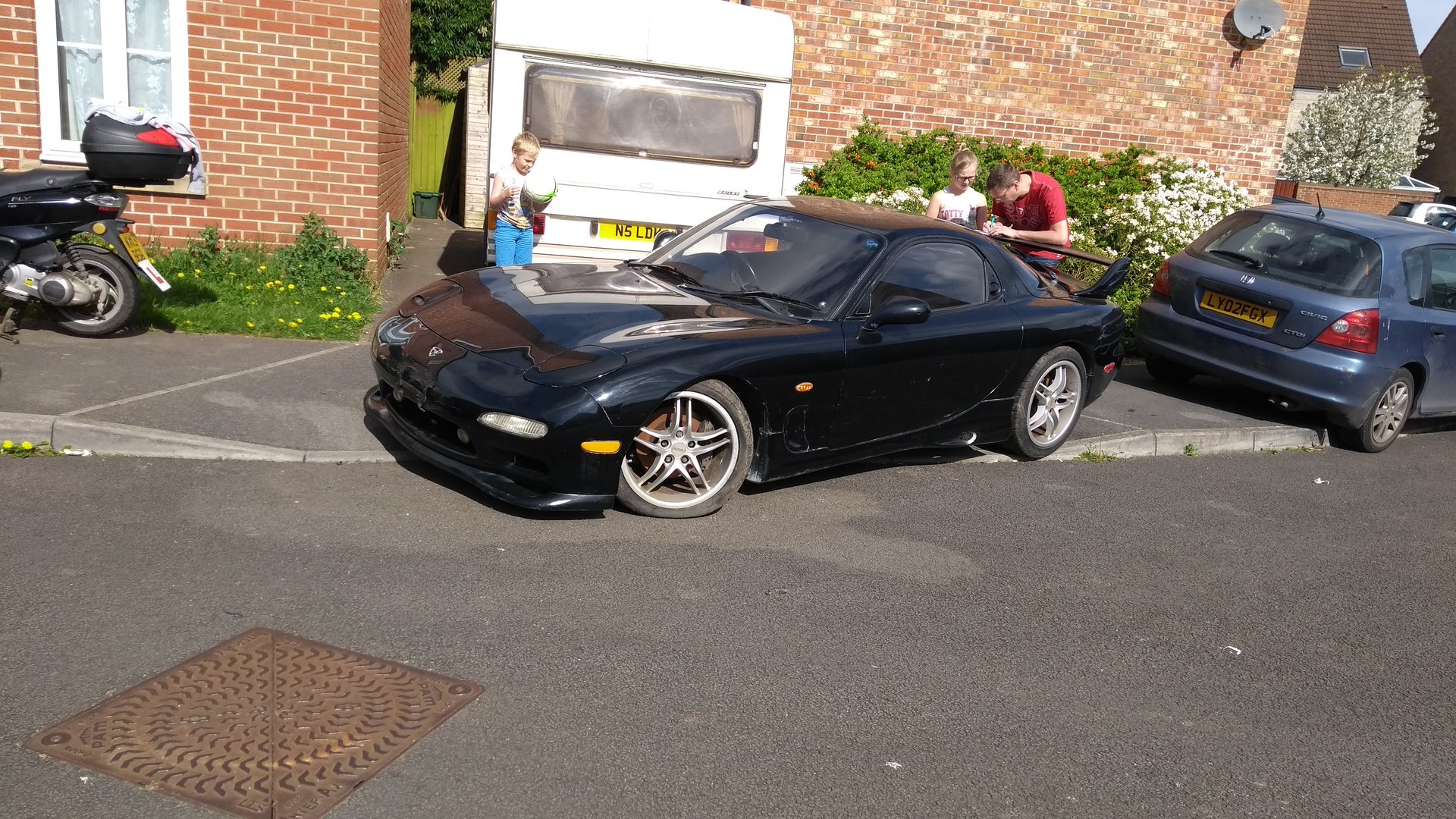

I had no intention of buying a non runner as my first rotary experience . But heres a picture of it the day i viewed it.
Off the road for 8 years ,Doors didnt unlock, no log book, broken door handles,unknown milage and history, kids bouncing foot balls off it ?.
As soon as i seen it i knew i needed to save this crazy JDM legend.
A deal was done and i had it picked up which took 2.5 hrs to load because it was so low and had flat tires.

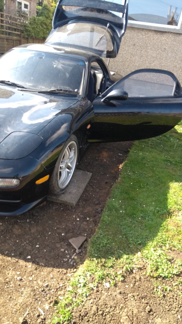

A few hours later she was home.and thr next day i set about opening the seized passenger door as the handle was snapped off and none of the bars to open the door worked either.

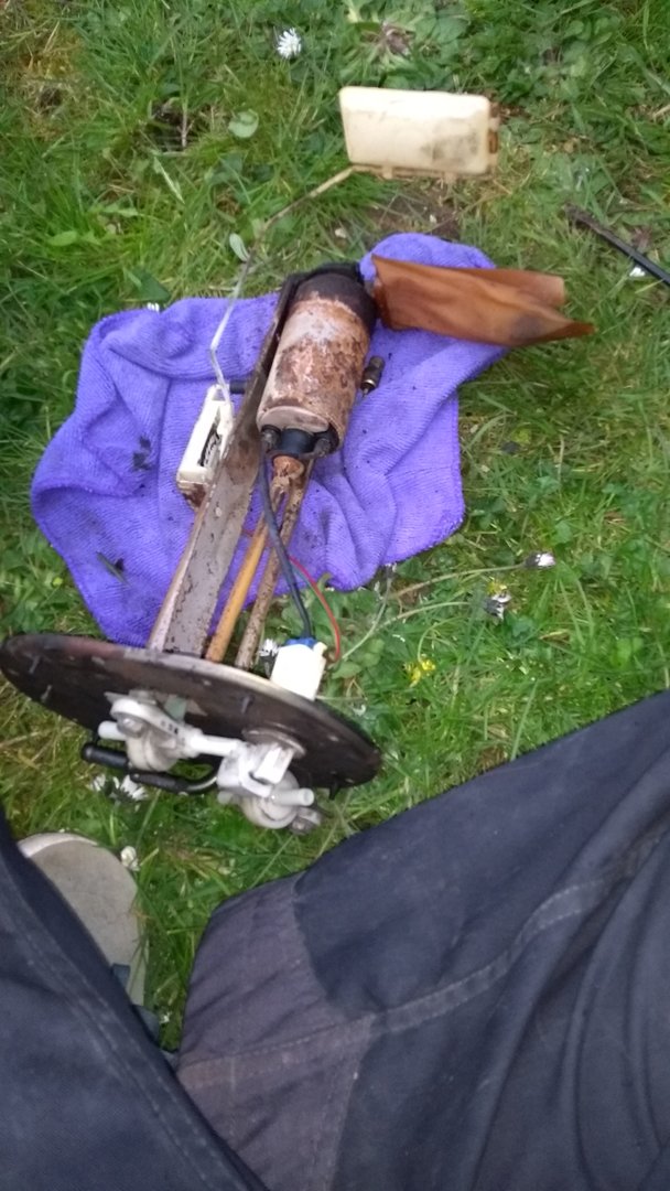

Next job was to inspect the fuel pump and lucky we did as it was seized solid
Lucky we had a cheap spare fuel pump we banged in it for the time being and turned the car over, it sounded like it wanted to start but didnt catch.

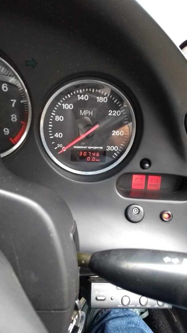

We were so happy to see only 30k miles on the clock(converted from km) which was backed up with the jdm history which i converted with google translate ?.

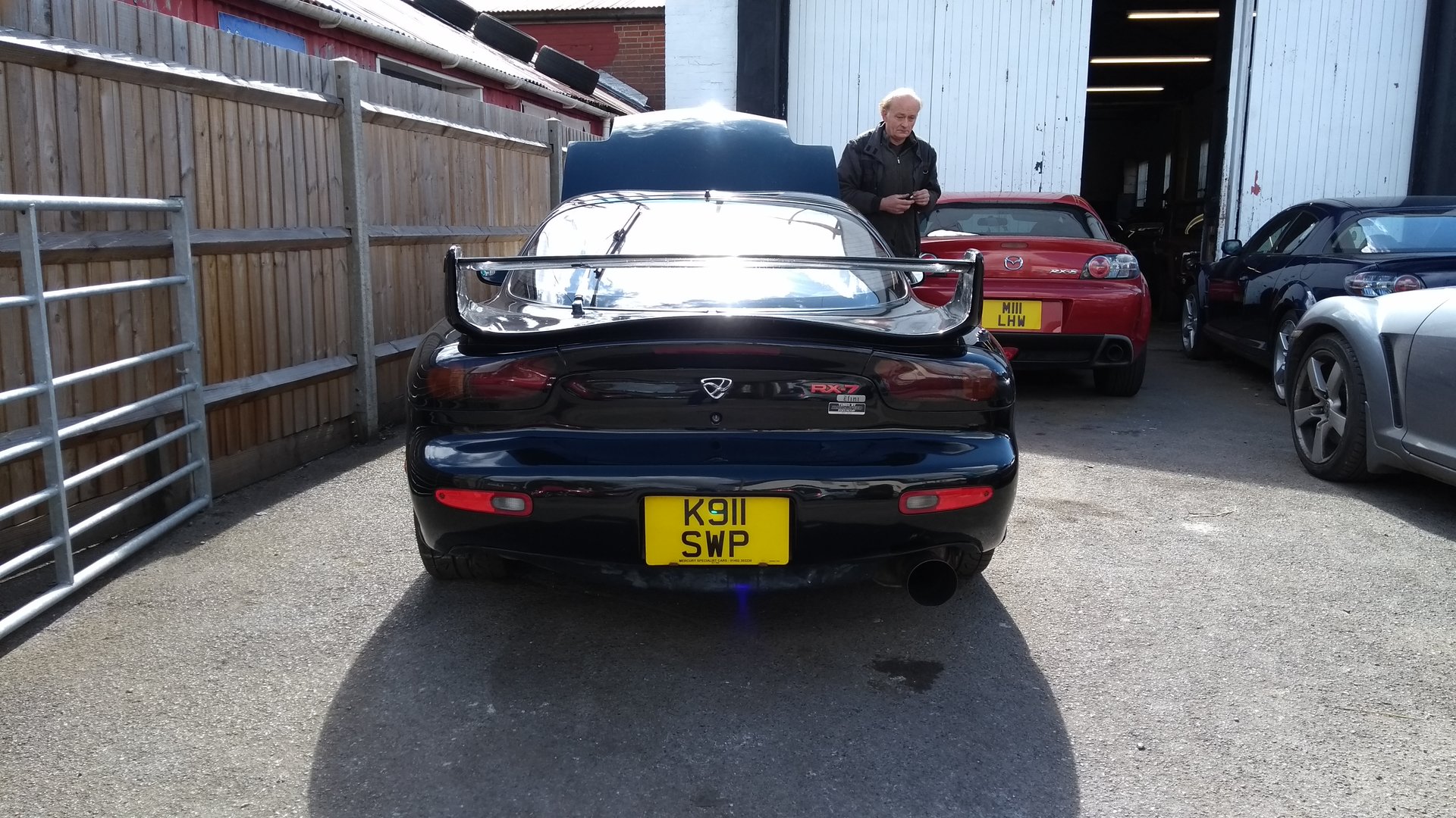

Now the car was running it was time someone who knew what they were doing was to look at the car ,so off to tim at RX motors to have all fluids and a check over and any work needed for the mot.

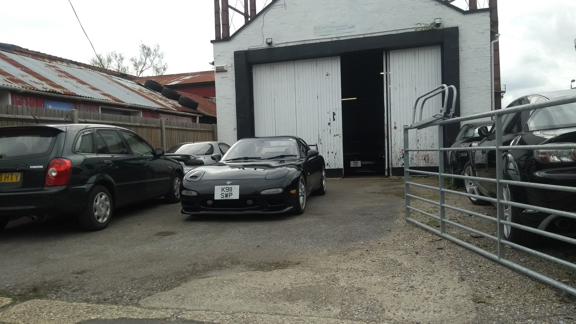

And dropped at tims

Couldnt thank tim and ian enough they were brilliant and real nice guys.

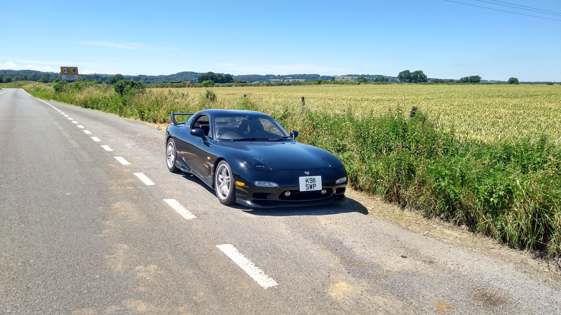

I drove it steady on the way home and the day after i took it for a blast down the roads to cheddar.
This drive really opened my eyes to see how quick this car really was and how well it handled . Made my 350z feel slow and fat so that got sold soon after ?.

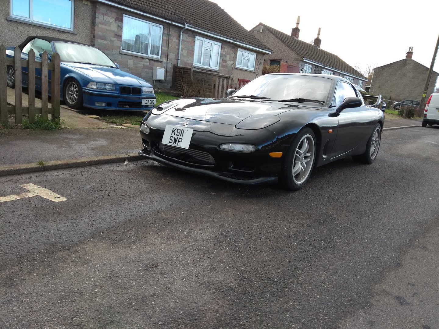

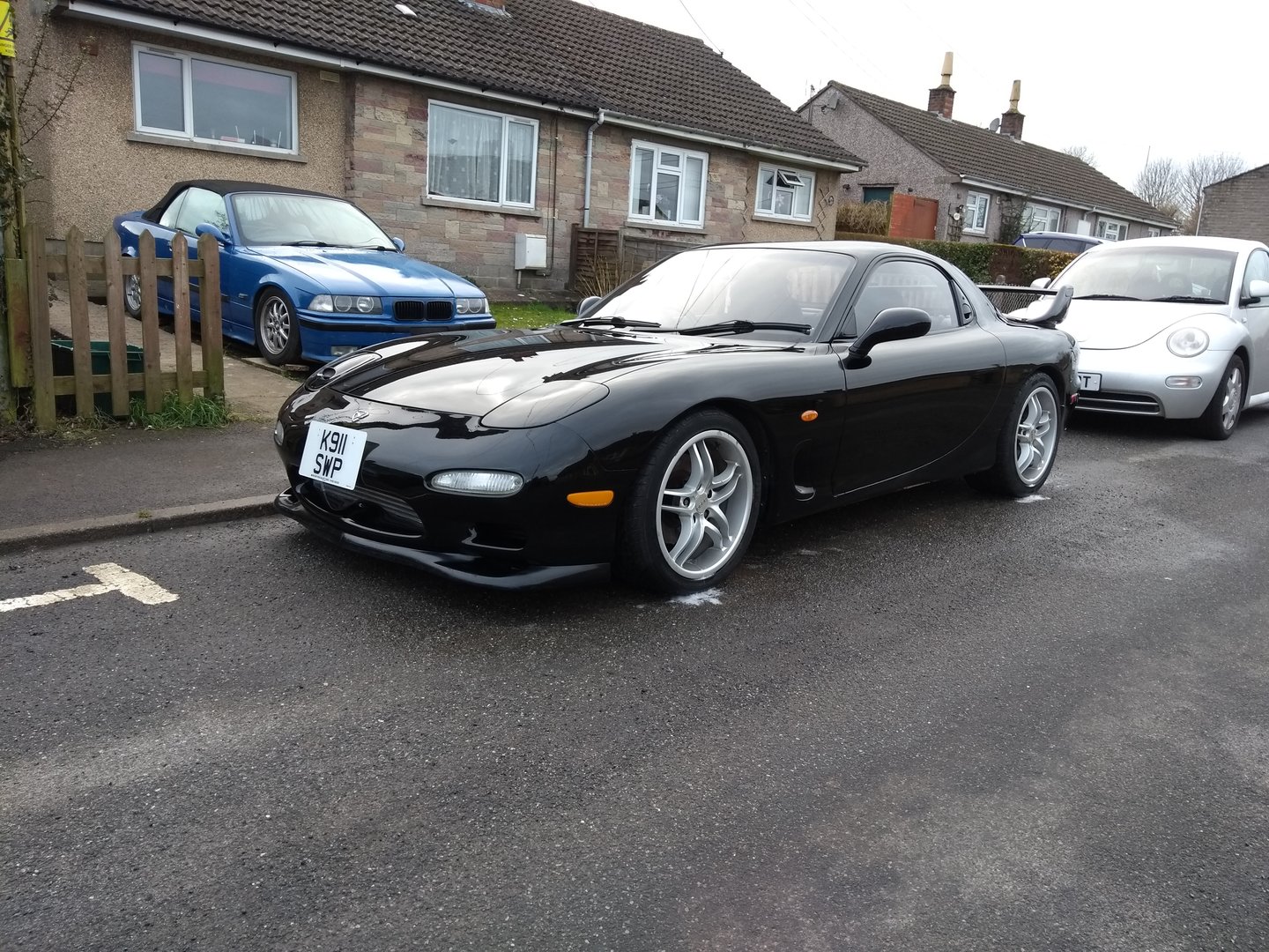

Had to pop over to my cousins house to get a pic of it next to his r34. We were very happy with life right at this moment.

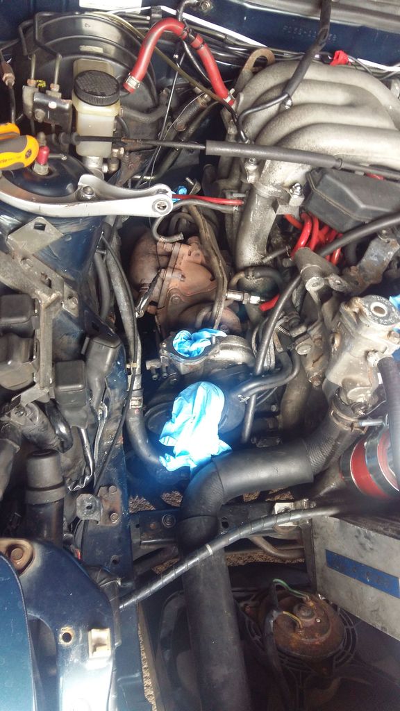

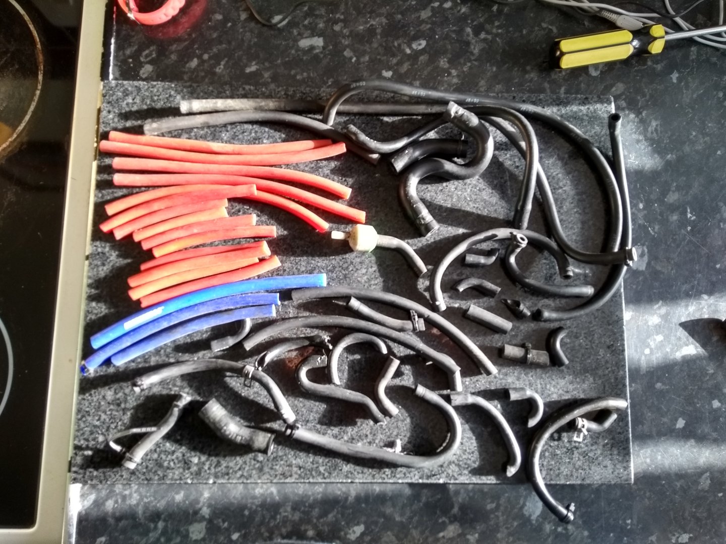

So i redid the whole rats nest with better sillicone hose, also deleted the air pump and fitted a dm idler pully, new ast tank, new vaccume chamber and a few new solenoids and aircon delete and new ht leads.
Heres all the old junk removed , it did its job but i wanted it looking good and all new.

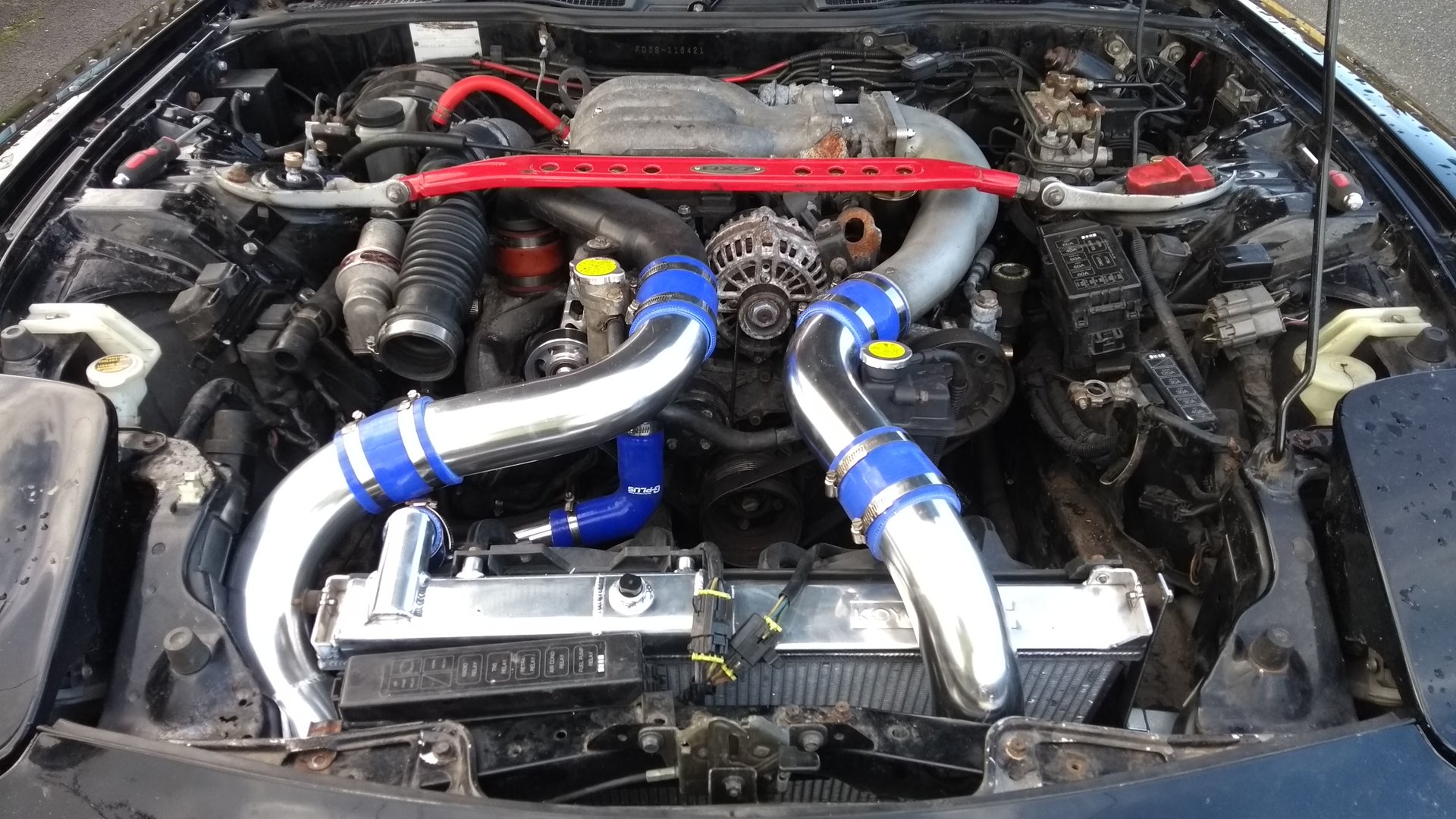

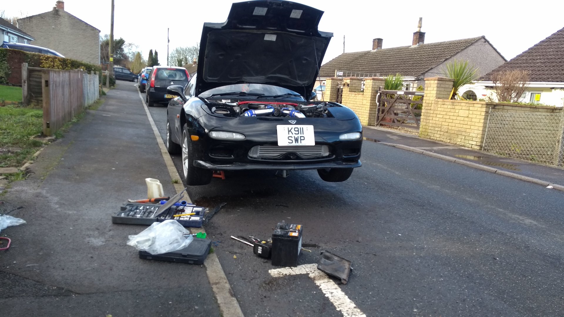

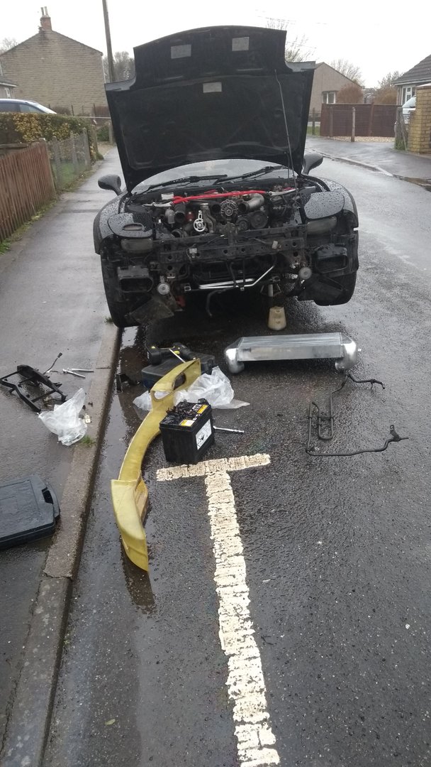

Now i was happy i thought lets bang a front mount on it and a koyo n flow rad.
To be fair i had these parts for months and was dreading fitting them.
Yes i did it out on the road and in the pouring rain but i soldiered on , i got it all fitted and only have the ast tank /air filters and battery to relocate which shouldnt be too bad.
Now all i have left to fit is my new downpipe and the boost controller the get it remapped.
