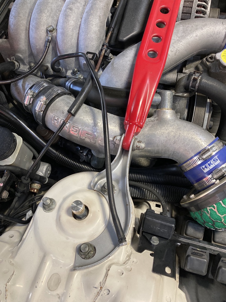

Hi,
Just after a bit of assistance Got my 2000 RS yesterday from the port and was delighted to find that someone had stolen the Apexi ECU & controller during shipping.
Long story short I managed to get a Series 8 ECU and get the car running but it is now only boosting to 0.6 bar.
I have attached a photo of a blocked off vaccum line on the manifold and was wondering if someone can point me in the right direction of where this needs to be plugged. I'm not sure what has been removed from the engine bay during transport.
Thanks
Hi that is usually plugged and used as a boost source for a gauge or boost controller etc iirc
Looks like it was probably like that in Japan. May have been for a boost gauge. Didn't realise they were as ballsy now to steal ECUs. Thats a massive shame

I imagine, unless it's bone standard of which i doubt as it had a pfc fitted, that the s8 ecu is limiting boost due to creep.
I have managed get the car running with a stock series 8 ECU. Just been sorting out the basics with oil change, coolant change, new filters, Compression check etc. Also working through changing some of the old vacuum lines. The car has low boost on the primary and intermittent on the secondary. Hopefully get to the bottom of that today.
As for non standard parts - its runs an HKS RS Intake, Knightsport Titanium rear exhaust with R Magic Centre Pipe, Autoexe Underbody Bracing and Ohlins Adjustables. Loosing the Power FC has taken the shine off it tho and I am claiming for a new unit and tune.
