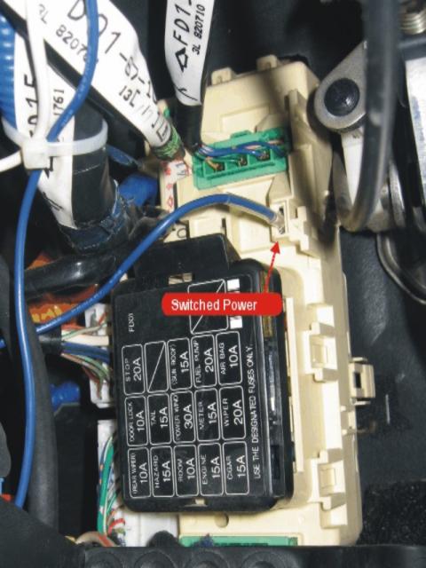

Is there any good power and ground sources inside the car apart from the stereo? Is The cigarette lighter easily accessible? Is there any others as i need to wire in a boost controller and my meth kit and i already have a few things tapped into stereo source so don't want to overload it.

There's an ignition live in the fuse box in the driver's side footwell. You can see it's a spade connector sat at its own in the top end of the fuse box..
Run your stuff to that and stick a fuse inline.

Any idea on spare connector size? So i can order a pack.
Apparently mazda predicted people would have the need to wire things in.
Normal sized male spades dude.
