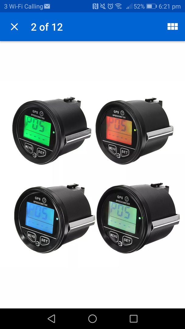

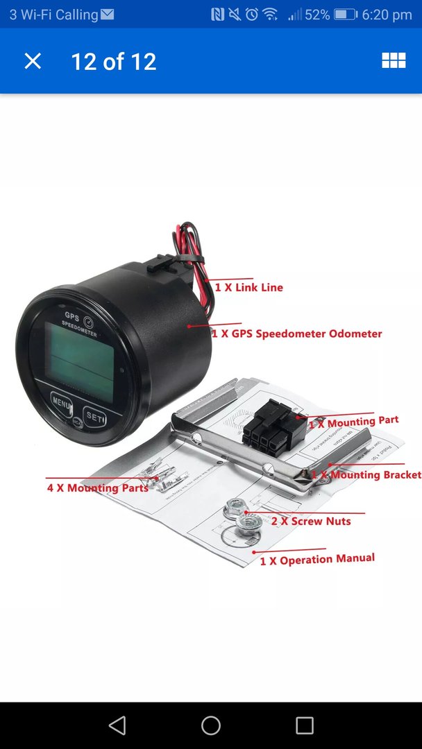

Might be a daft question but my car as are most fd's read in Km, someone previous to me has put little stickers on the speedo for 30mph and 60mph which looks shit and I can't see them at night.
I've seen this on eBay which is interesting
Possibly could fit it in those steering wheel cowl gauge pods.
What's people's thoughts.
I've also seen ones for obd but fd's don't have obd.

That looks very deep, and think you might struggle getting that in the cluster. speedhut do slimline ones if that's what you want.
Sounds like you need a converter box rather than a new gauge, I've got a little kph to mph converter that is just spliced in the speed signal wire.
I wouldn't personally bother if I was you, if all you want is mph reading then there's two perfectly good methods in this thread!

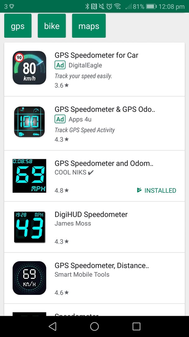

What app do you use? I use mine sometimes as extra insurance when going through speed cameras ha, it only shows speed tho
That one (cool nicks), I've not tried any others so there could be better ones, I've also only used this one twice so far as I've not really been out properly in the car
