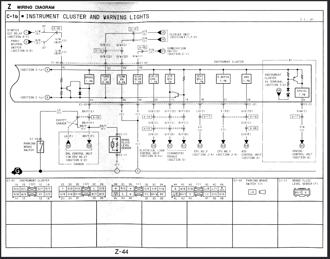

Diagram for the cluster:
Just figuring it out exactly, I'll let you know if I work out what wires to cut but I thought I'll give the diagrams in the meantime...

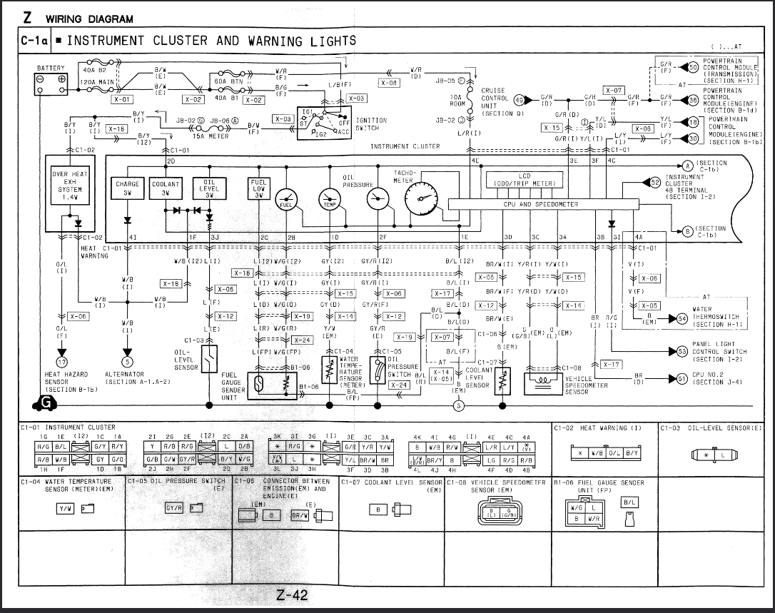

I was expecting one speedo wire but there were two, hence why I was confused, it should be
speedo: 3C 3A
temp gauge 1D
temp light
oil pressure 2F
oil light 3J maybe?
tach not sure yet
fuel 2B
fuel light 2C
ignore the second page I sent thats just illumination I meant to send the other half but I dont think its too pertinent to what you need to look for:
