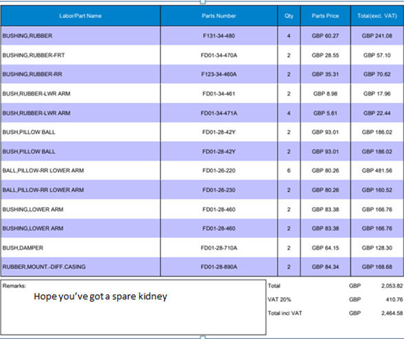

So I'm gonna go all OEM I reckon, I did it with my Eunos and I dont regret that! Does anyone have access to all the part numbers I'll need? I've found a few on the forums but I cant locate all of them. To be clear I'm looking to change every bush on the underside. Cheers!

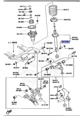

I used this:
and this
to work it out, it wasn't too hard to look at all the pics and correlate the bits.
Then I went into Mazda with a printout, and the guy at the parts counter could find everything on their system, it was almost all available without any trouble (just slow shipping times)

I used this:
and this

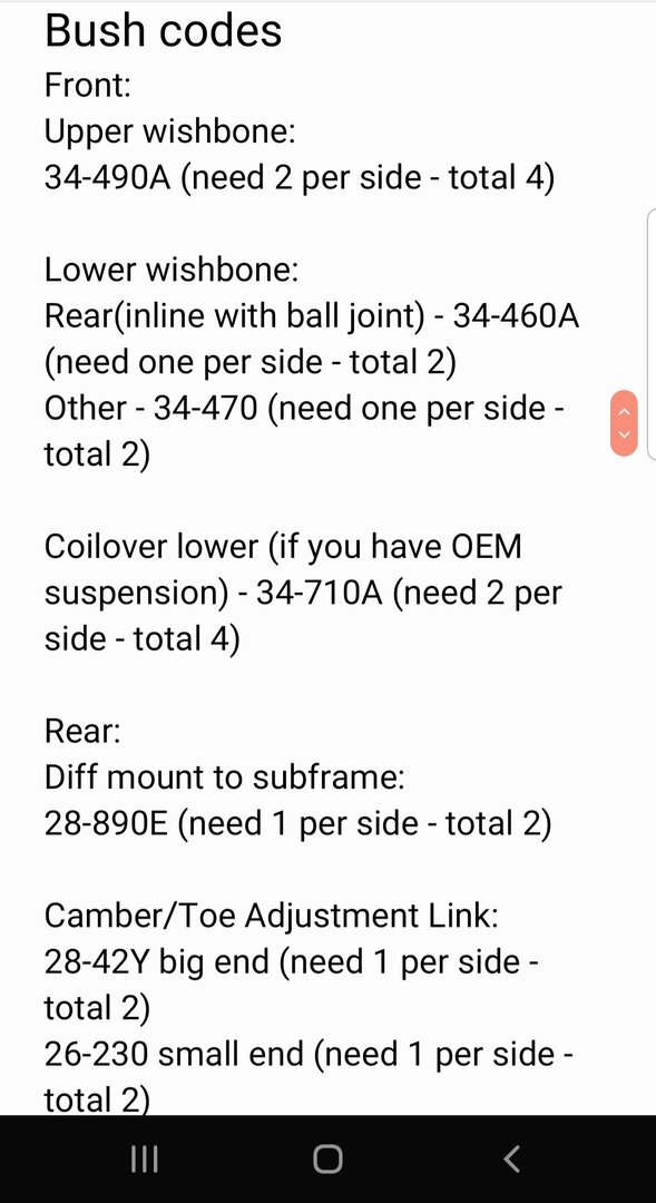

Thank you so much for this! I'll rifle through and get a definitive list and post it up here for people who'll need it in the future (y)

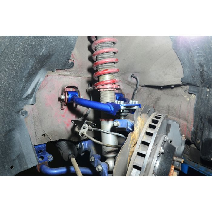

A definitive list would be very handy. Thanks for putting the leg work in. Am a fan of Hardrace bits so the link above is also really useful to see.

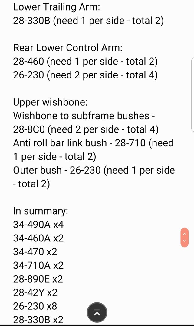

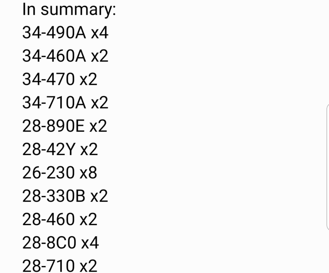

Okay so I've located all the bushes needed! I'll post up the 5 digit catalogue identifying numbers for now since that's what you'll need to get the parts from a mazda dealership. When my heads less frazzled I'll get the actual part numbers in case you want to buy from Nengun or Amayama!
