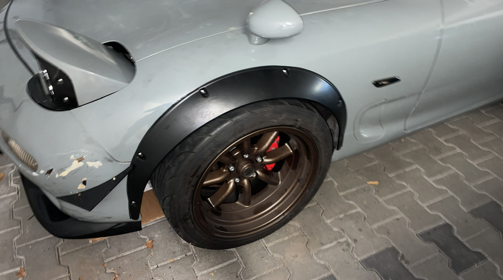

- fitted another over-fender so i am allowed on the road again

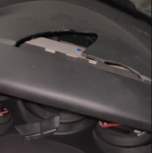

Also found out, part of the heat issues is a missing seal which stops the engine heat from going into the cabin.

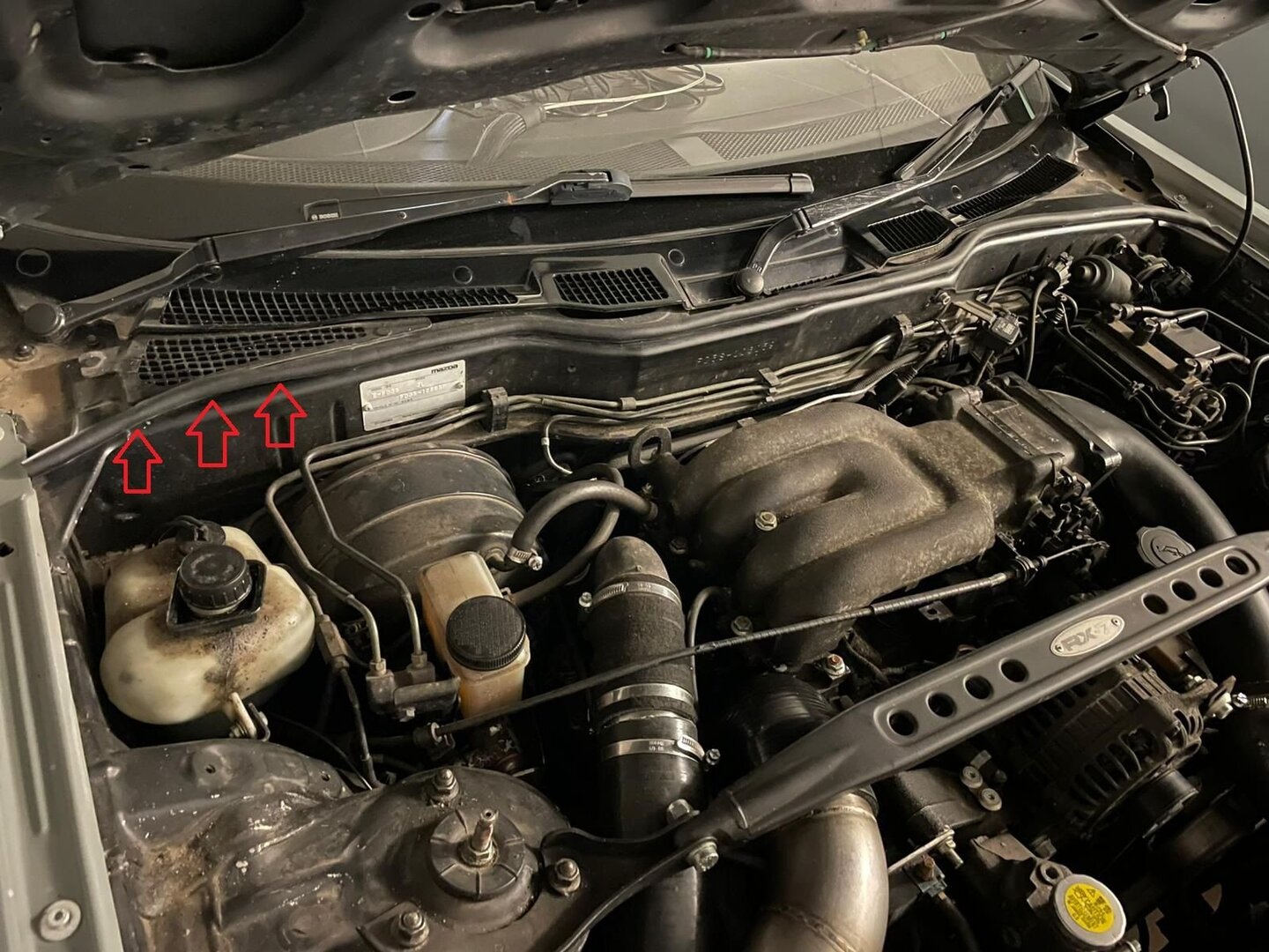

  1. After driving for more than 10 minutes the interior got hot, like extremely hot. The heat came from the gearbox and from the ventilation system - the first one was missing the insulation, the second was due to a missing weather strip. The insulation was easily bought off the shelf from a local RX-7 workshop but the weatherstrip was NLA - so i built one myself using some clips from a set i bought on amazon and got myself a universal sealing strip (14mm i believe). Made a small hole in the seal, put the rear of the clip in, heat resistant glue, done. Works great - finally comfortable driving.

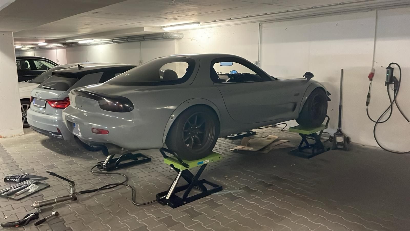

  4. And i got myself a kind of "lift". Since i am obviously not allowed get a 2-Post lift or anything fixed in the parking lot, i needed something that can be moved, can't burn and doesn't need electricity. This small ramps get the car up by 45 cm / 17 inch and thus i have roughly 55 cm / 22 inch of space under the car.

They are sold by TRUTZHOLM, a germany based company and white-label produced in china. So far i am surprised by the quality, however the price is quite steep imo. I only worked with them once but so far i like it. I just keep the car parked on them so i have no issues with storage or anything. So far, no one complained ;)
You can find them on ebay as well: Click here
If you have specific questions, lmk.
