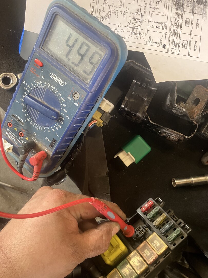

Checked on the white cable with red stripe (at pump) and 0v showing. working back through the front relay ( think it’s NF01) to the yellow relay to the green relay I’m showing only 5v on the blue cable with relay removed.
I’m assuming I should have 12v at this point which then gets switched down the blue with red stripe continuing down the sequence of remaining relays?
I’ve checked at the 15amp and 20amp fuses at the drivers side footwell and both showing 12v out fuses are intact.
Can anybody confirm these voltages for me please? I’ve attached a couple of images for clarity showing which pin goes to which color.

Thanks Joe, I was sure I was ment to have 12v here at the blue, but I just needed it confirming to carry on my fault tracing.

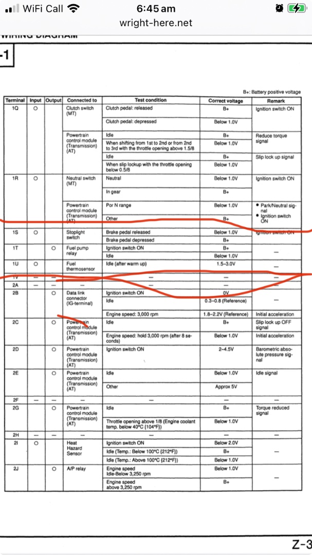

Ive checked continuity on the earth side of the relays coils and this appears to be the issue on both relays ( circuit relay - blue and black cable which goes back to 1T ecu plug) and ( fuel pump relay - blue and white goes back to 1K ecu plug)
Both are showing continuity between the ecu pins and the relay spades and they are complete circuits (perfect) but I have no earth continuity on the pins 1T and 1K to chassis ground.
Does the ecu switch the earth out down 1T and 1K? Or should these be permanently earth regardless of ignition switch position?
Yes the ECU is switching the relays depending on it software. Have you tried simply trying to start?

I can’t confirm this (theory based) but I’m lead to believe that 1T terminal from the ecu (blue cable white stripe) is actually both a earth and live cable hence finding it impossible to test the function of the coil staying energised on the relay. When the ignition is switched the white and blue gets sent a earth pulse followed by a live to close the relay contact (providing a fuel pump prime) then when engine is cranking and running it provides a constant earth energising the relay, thus switching the 12v feed to the fuel pump relay speed (nf01)

Does any one have any understanding of terminal/cable 1k (from ecu) and how it operates as the description in the wiring book I can’t get my head round. I can’t keep this relay open (closed contact) but have the switched 12v present on the green and black cable?
