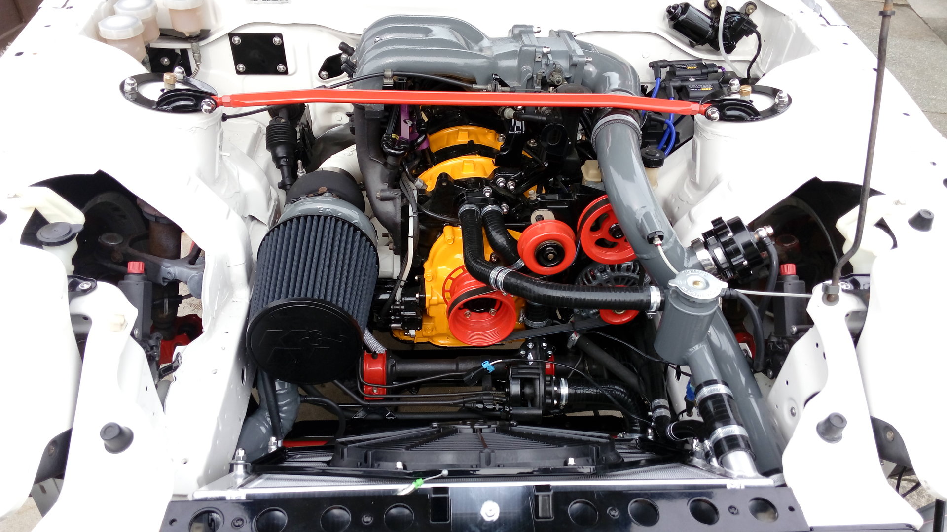

I did a tidy up and it now looks like this (when I did it, bit dusty now). This was a progress picture, the inner arches are now in the car !
Proper engine bay goals right there.
Is that the "Electric Water Pump Block Adaptor" from DM Motorsport?
Out of curiosity, what did you do to remove the filler neck and from that, where does the thermostat now go (does it even need one with an electric water pump)?
Good to hear you found an air leak. I've never seen that (everyday a school day), when it had the stock system it always overflowed when there was air in the system then settled down.
The engine bay is well over 12 months worth of work ! The adapter block is something similar to the DM one, there has been quite a few options over the years.
The adapter is basically where the filler neck fits to the main block ! There isn't a thermostat in the loop now, thats where the pwm comes in. It takes longer to warm up, but its not too bad once you play with the map.
