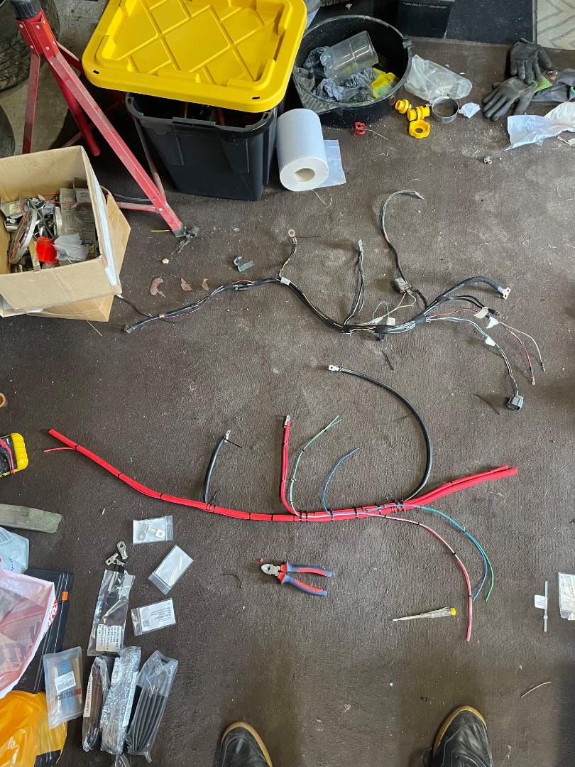

I’m currently looking into reverse engineering my own harness with new parts..
Chasing a voltage issue and the charge harness is looking very tired
So..
Bit the bullet and order up some bits to make my own charge harness, I’ve also stripped everything that’s not used, so the harness is very simplified.
There's not a lot in the charge harness.
My engine loom i completely eliminated it.
Just need one big cable that connects alternator to the battery
