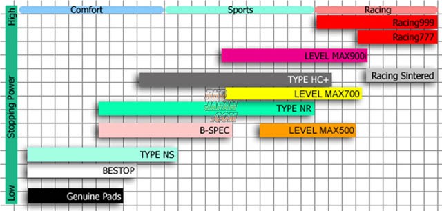

Just purchased front and rear Ferodo DS2500s. Quite expensive for these pads but less expensive than my Project Mu's.
They certainly cost enough but were recommended by so many including Stu at Rotor Torque who swears by them, so I hope they live up to the bill!
I thought you were looking for a step up in performance from the HC+ for track work? If you go careful on them, then they're half the price of a track pad, so a good cost save at least.
I was but the guys in this thread plus Stu at Rotor Torque convinced me to stay within the same realm of the HC+.
