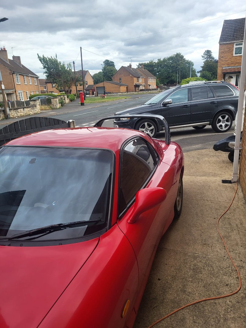

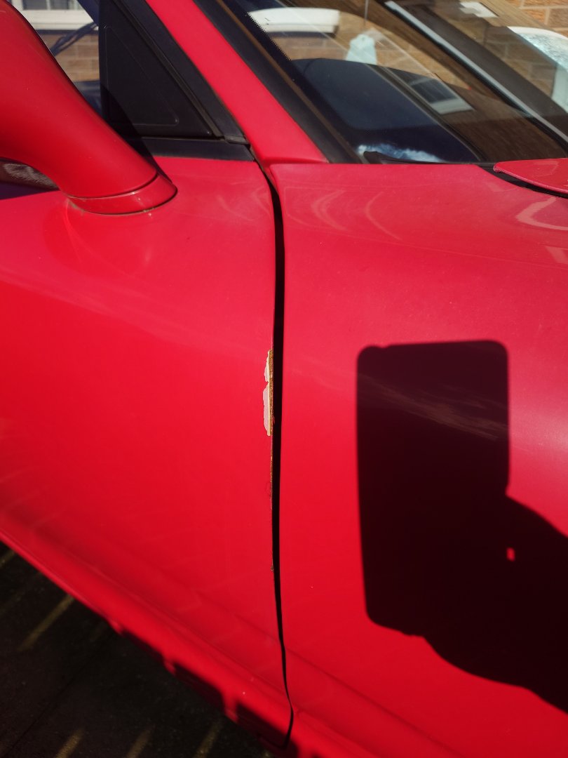

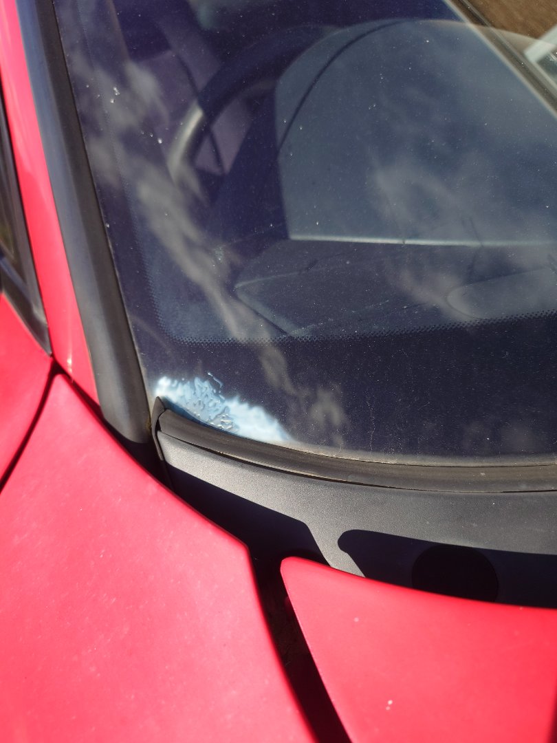

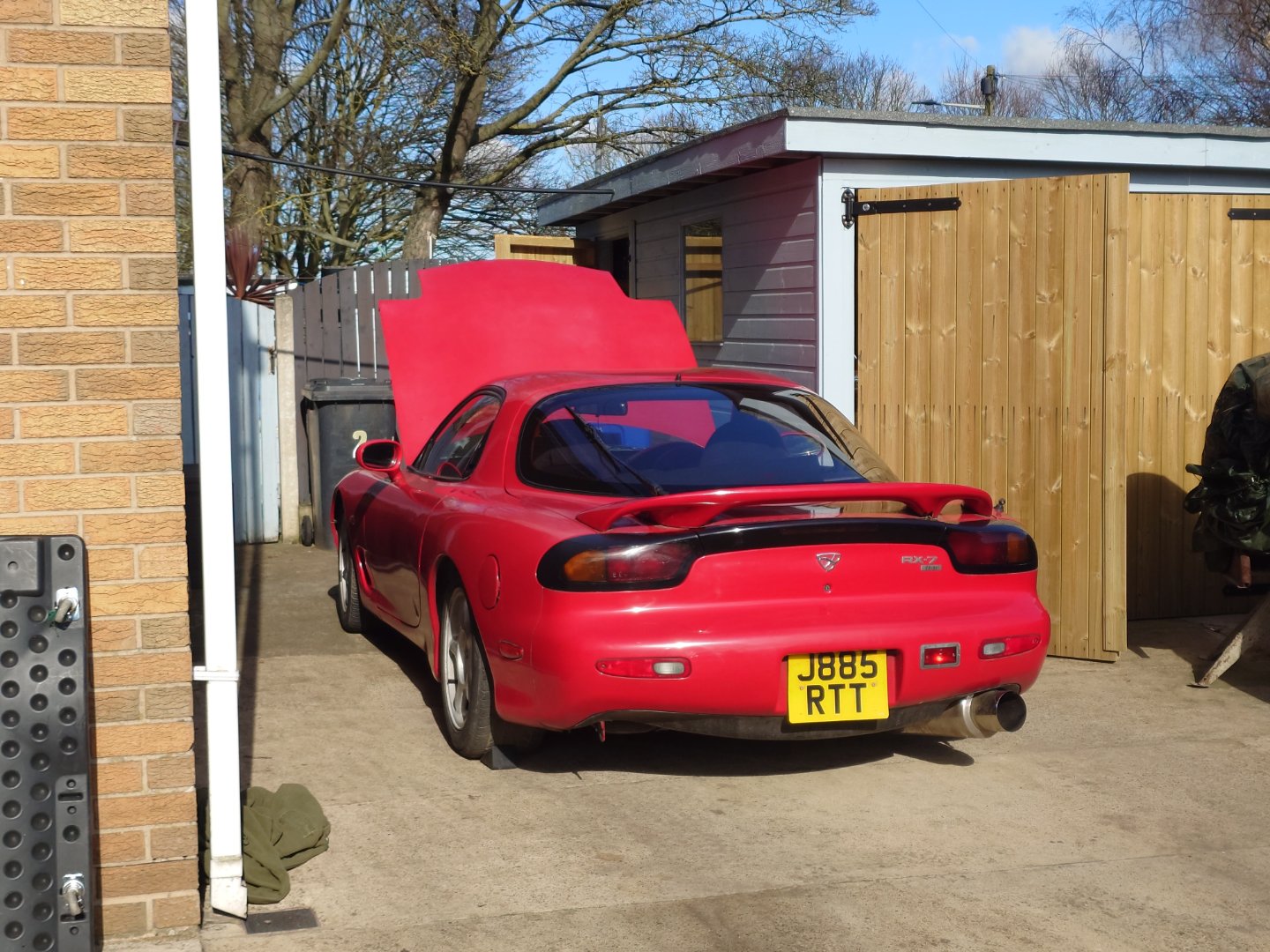

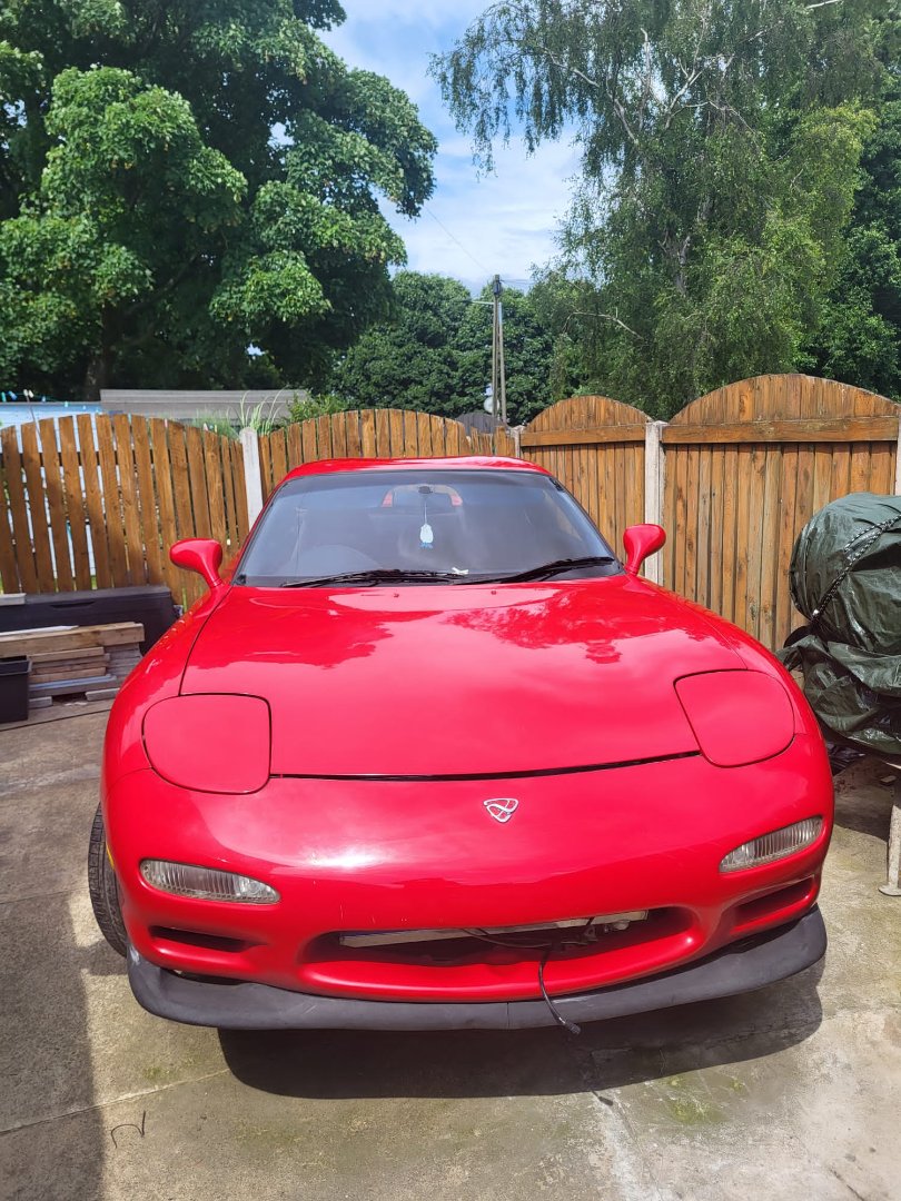

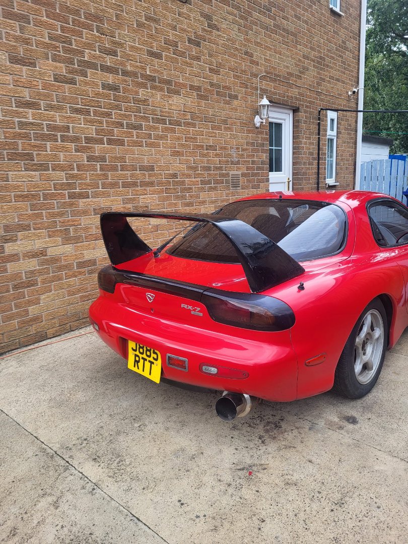

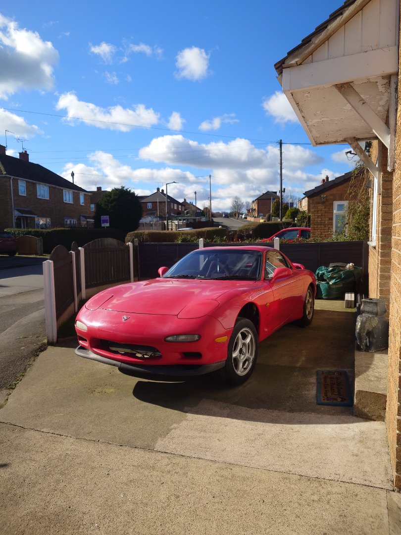

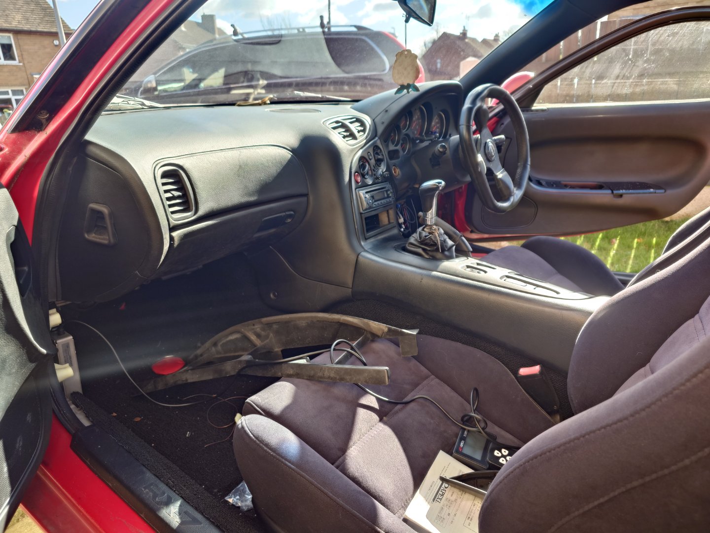

The condition of the interior is probs a 7/10. Terrible plastic, door card handles are cracked, paint is faded, spoiler is peeling away. I'll try to upload a couple of pics
I hope these pictures help. I think the paint is actually not too bad just a couple of little chips here and there, majority of the interior plastic is fine.

Im not sure what it running actually gets you, as from the photos it looks like faded paint and a not great interior.
So unfortunately puts you at the lower end of the valuation.

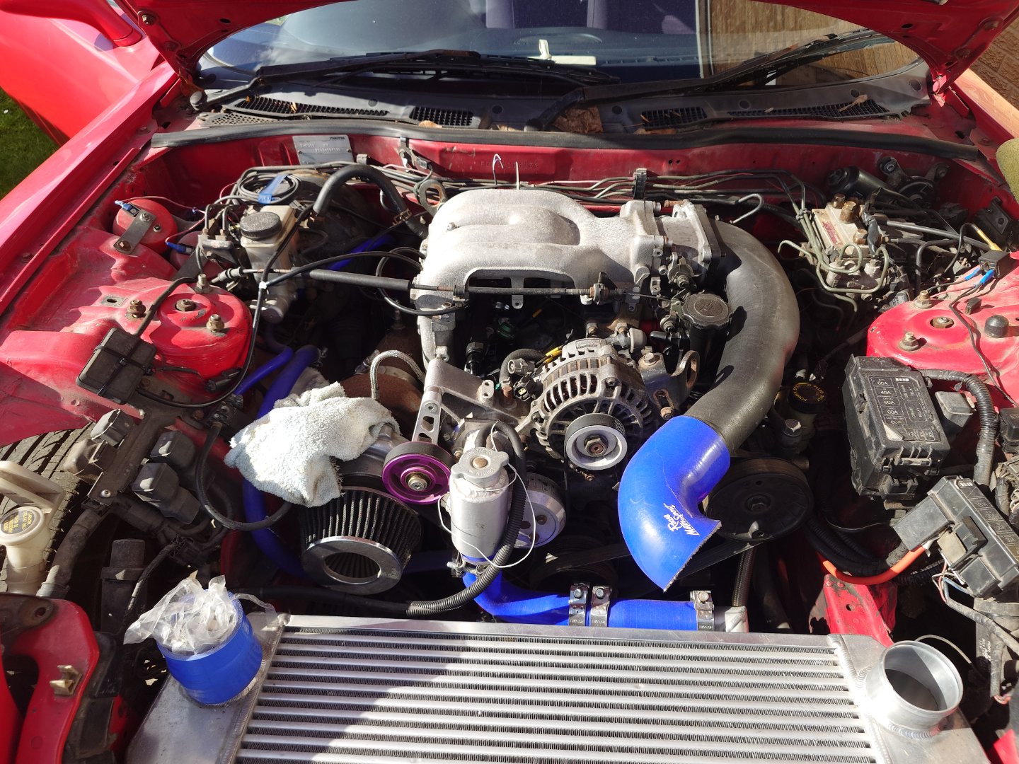

Everything in the engine bay needed for it to run is all put back together, engine turns over, spits and pops, it's so close to firing up. Me and my dad just cannot get it to run though. I suspect it just needs lots of cranking based off of YouTube but I wouldn't risk that without advise.

Things I would look at - the basics
How old is the fuel in it?
Is it generating good oil pressure
Has it flooded? Exhaust stinks of unburnt fuel.
Are the HT leads connected correctly
Are you getting spark and fuel delivery at the rail.
If that's all good I would try it again on easy start. If it will fire on that then it's fuel system related - which is what I would suspect.
