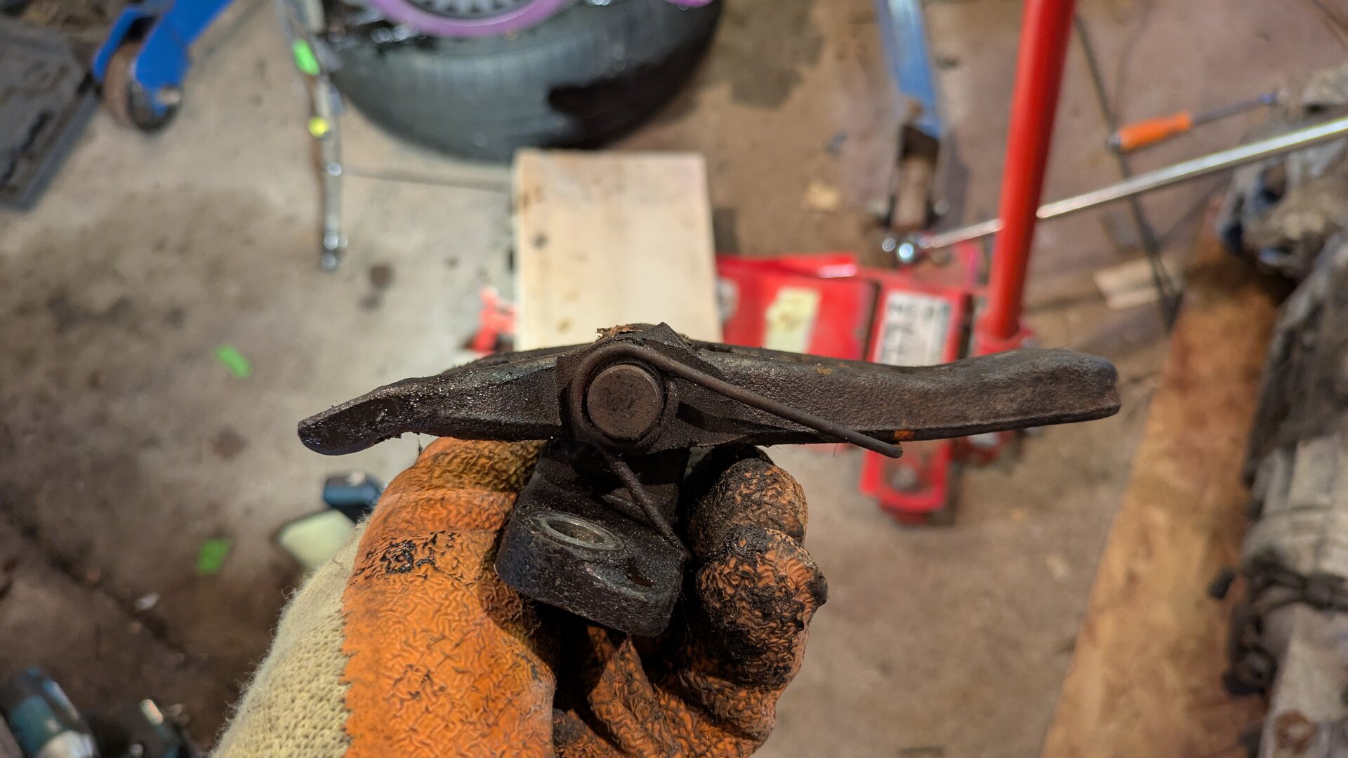

I had exactly the same symptoms with my HKS twin plate , after many hours of bleeding the clutch and putting new seals in the master cylinder it turned out to be a broken clutch fork. After doing some research it turns out that it common for the fork to break or bend.

So, post mortem, is this bent?

Not 100% sure it was the cause, but two of the clutch parts needed popping off the intermediate plate with a screwdriver. Not sure if they'd been overheated trying to park the bloody thing or what. Really odd tbh.
Pretty sure it wasn't the clutch fork, but I've bought a new one anyways. Comparison:
