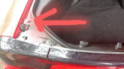

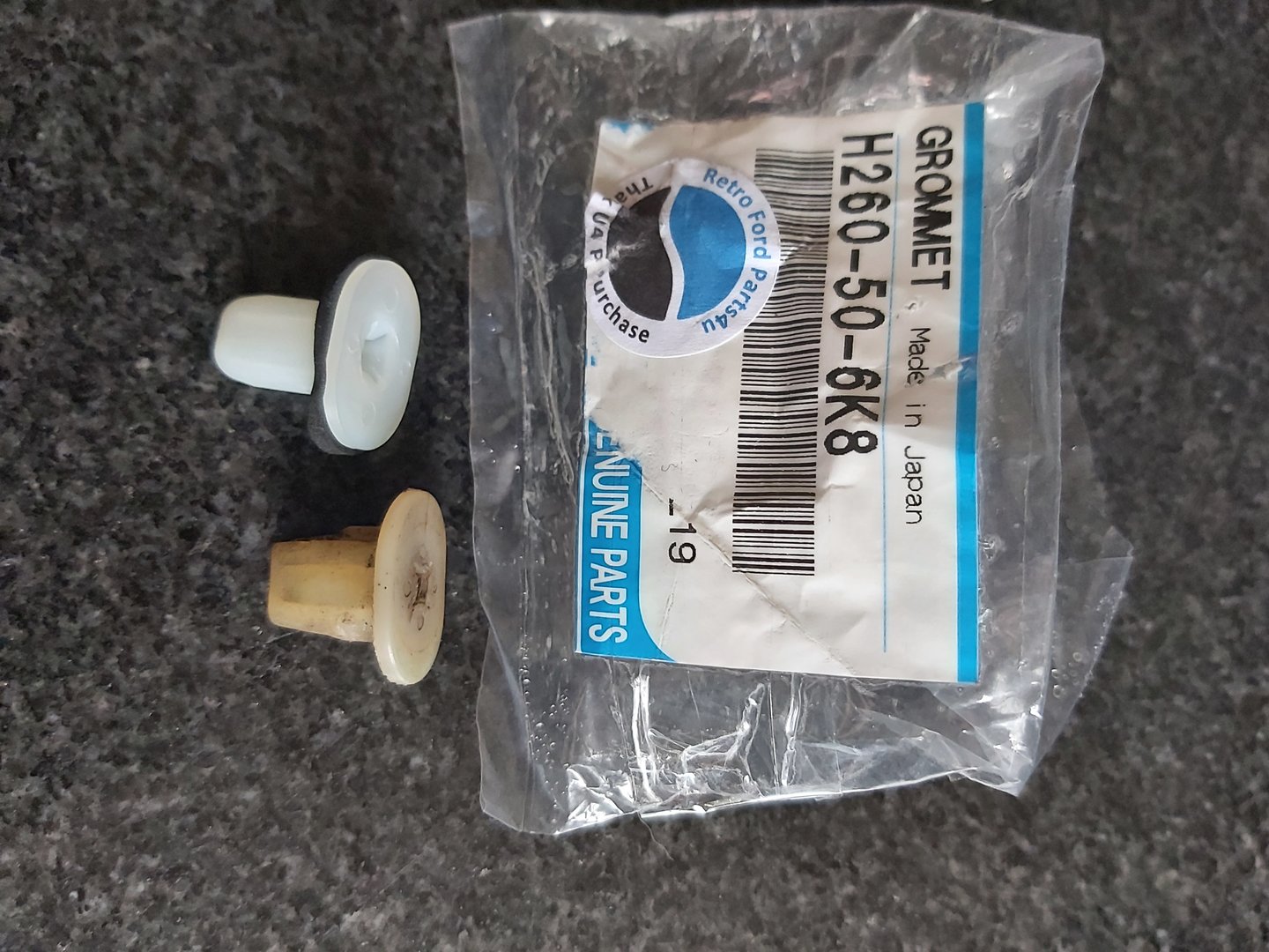

Does anyone know the part numbers for the clips u screw into for the triangle pieces above the rear lights , inside the boot.
As u can see in this detailed image ive modified with an arrow, under this screw is a white clip with a thread .

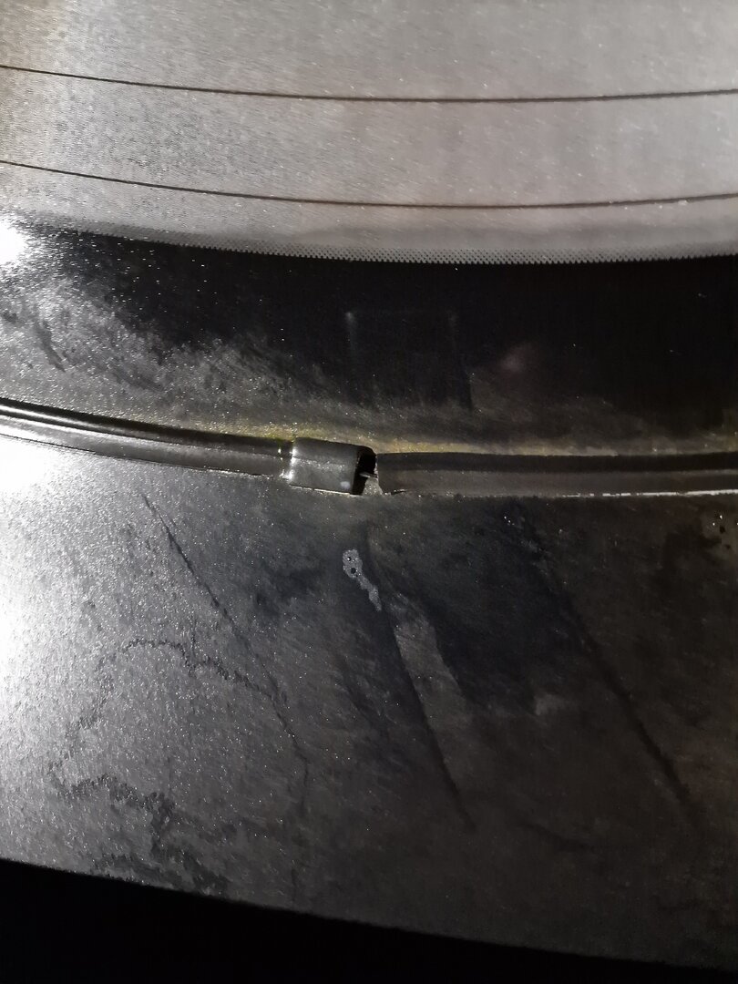

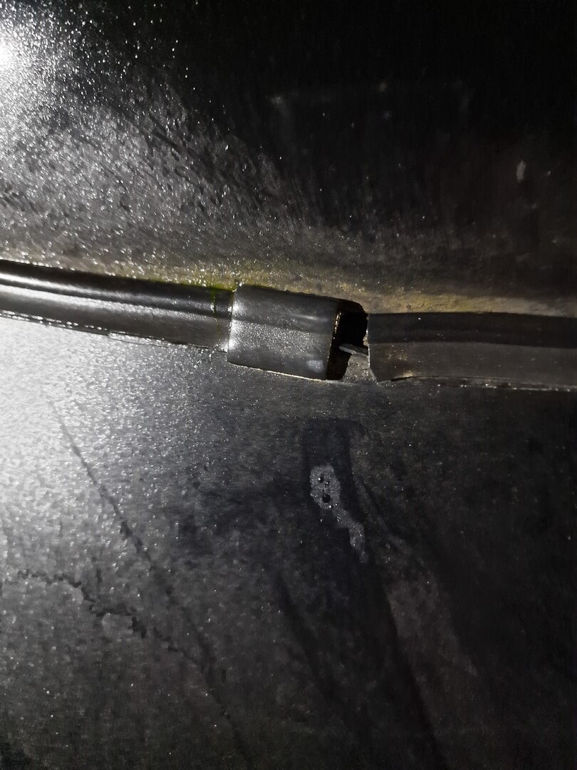

Think I found one of the sources of the leak.... Do I need this connecting clip or the rear window rubber seal?
looks like the rubber seal has shrank mine has too but i do not get water into boot. If u have a spoiler check its not leaking through the bolt holes.
No the trim is just a trim, the screen is sealed in. If it leaks around the screen that's odd unless its ever had a rear screen fitted/changed.
