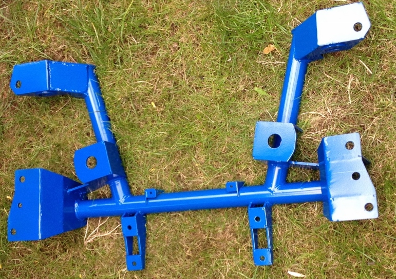

What front sub frames are we running and what motor mount kits do we think are the best ?
Both current and past were modified Mazda subframes by dynotorque if i was doing it myself either ronin or sikky (both great) whichever was cheapest.
Mines a custom jobby using the Mazda mounts
Ronnin are bringing out a redesigned subframe soon so might be worth waiting for that if you have the money to spend

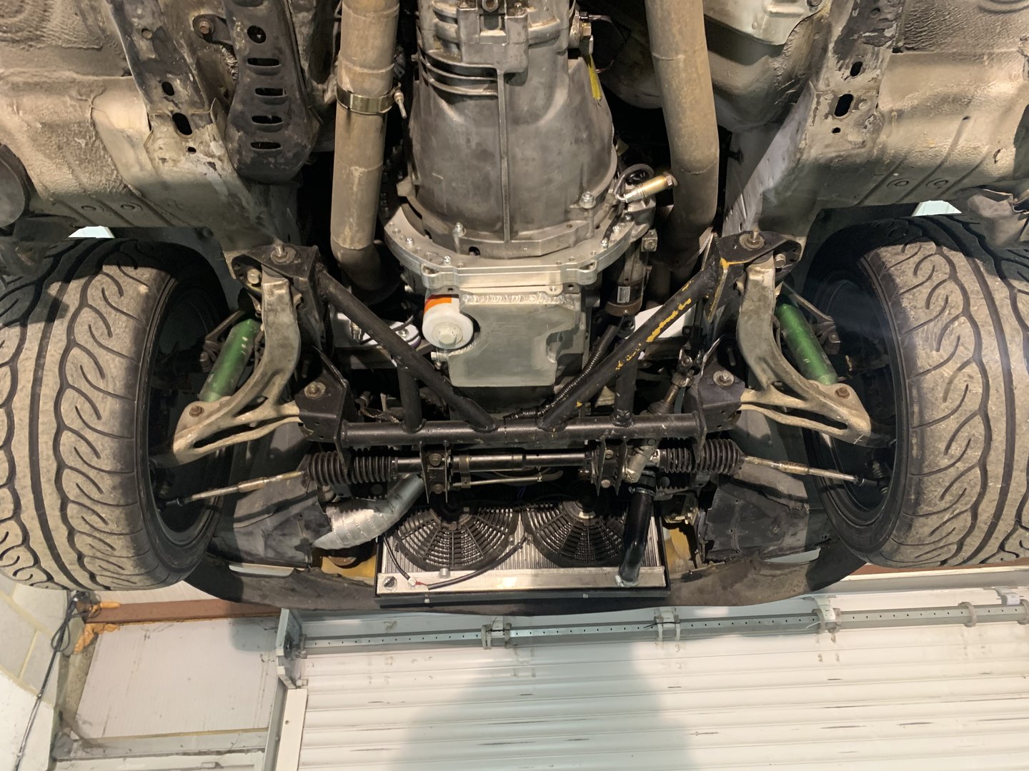

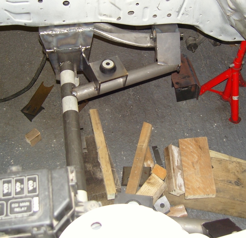

I built my own but its very similar to the samberg one, but it was time consuming.

Nice work on the subframe i wish i was a bit more experianced to build my own thats why i went down the bolt in off the shelf option.
