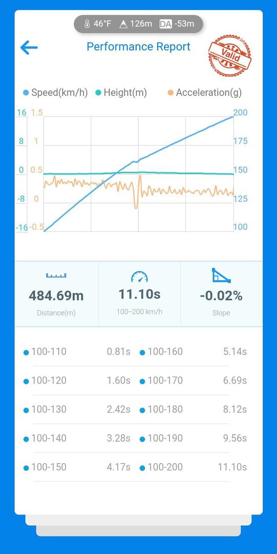

Below is a draggy run from Feb, showing where the car is at currently. The car has/ had a weird boost issue where the second turbo doesn't appear come on much (like the changeover doesn't happen) when planting it below 4k - it doesn't happen all the time. I did a couple of runs starting in 2nd to try and avoid this, but they were around 0.5s slower. The best run was starting in 3rd and I didn't have the boost issue that time. I feel like it could have done better, but IATs were shooting up, so I gave up and haven't tried again since!

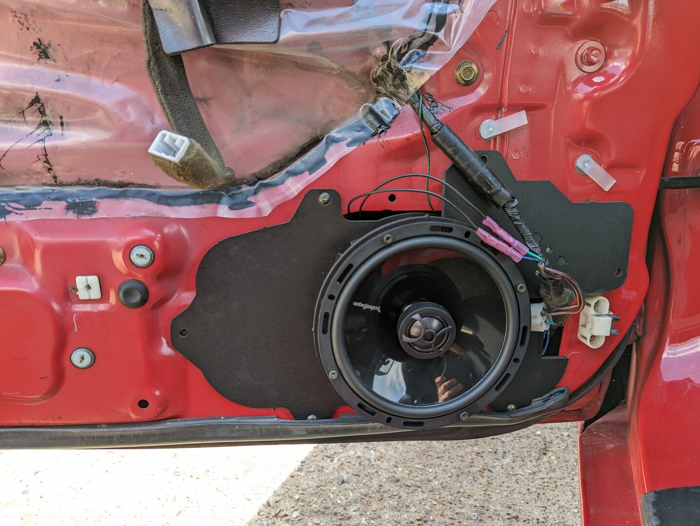

Next up (April), I chucked some 6.5" speakers in the front. Although they still sound rubbish, so I'm thinking to upgrade the wiring, get a new head unit and possibly stick a small amp somewhere next.... The car came with the funky Bose kit which wasn't working - I'll rip the rest of that out and store somewhere when I get a sec.

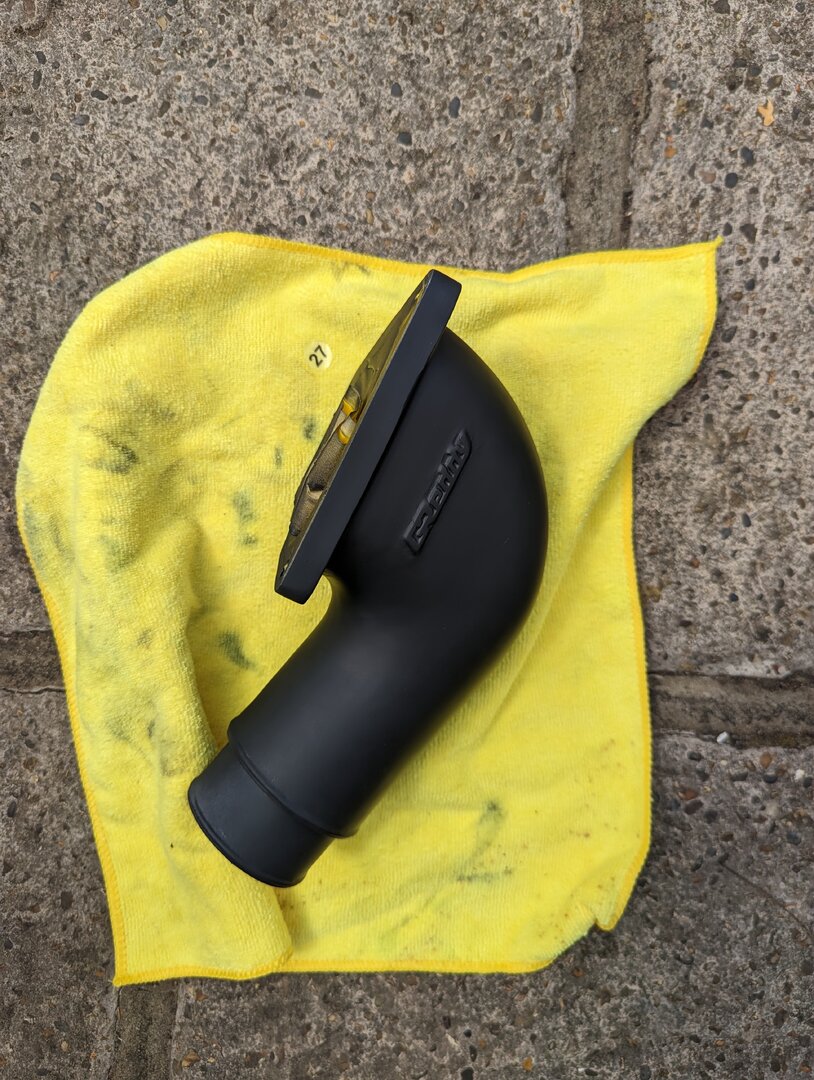

Greddy elbow (of course!) and Greddy OLED boost controller

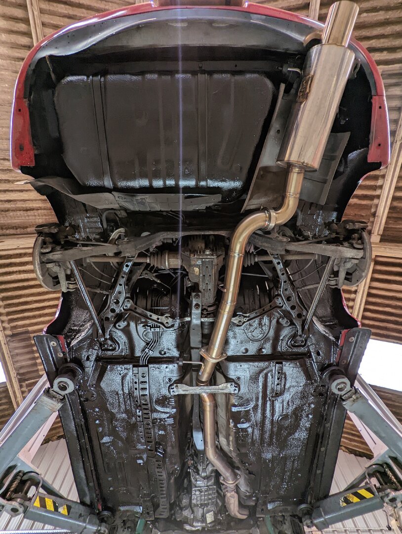

The car took a trip over to The Performance Shop who fitted my my clutch & flywheel, skirts and exhaust. The flywheel made a massive improvement to feel imo, I don't think I'd go back to stock weight again. The exhaust was also a massive difference, much deeper tone and finally one that doesn't leak!

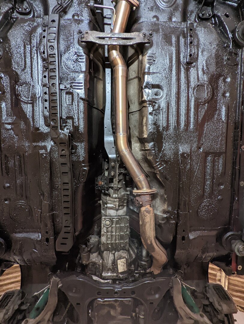

Colder weather is the only time I can use the car without IATs shooting up, so winter prep began! Stuck the car on a ramp and thankfully found no surprises underneath - pretty impressed with the underneath considering the age. All jetwashed and undersealed.

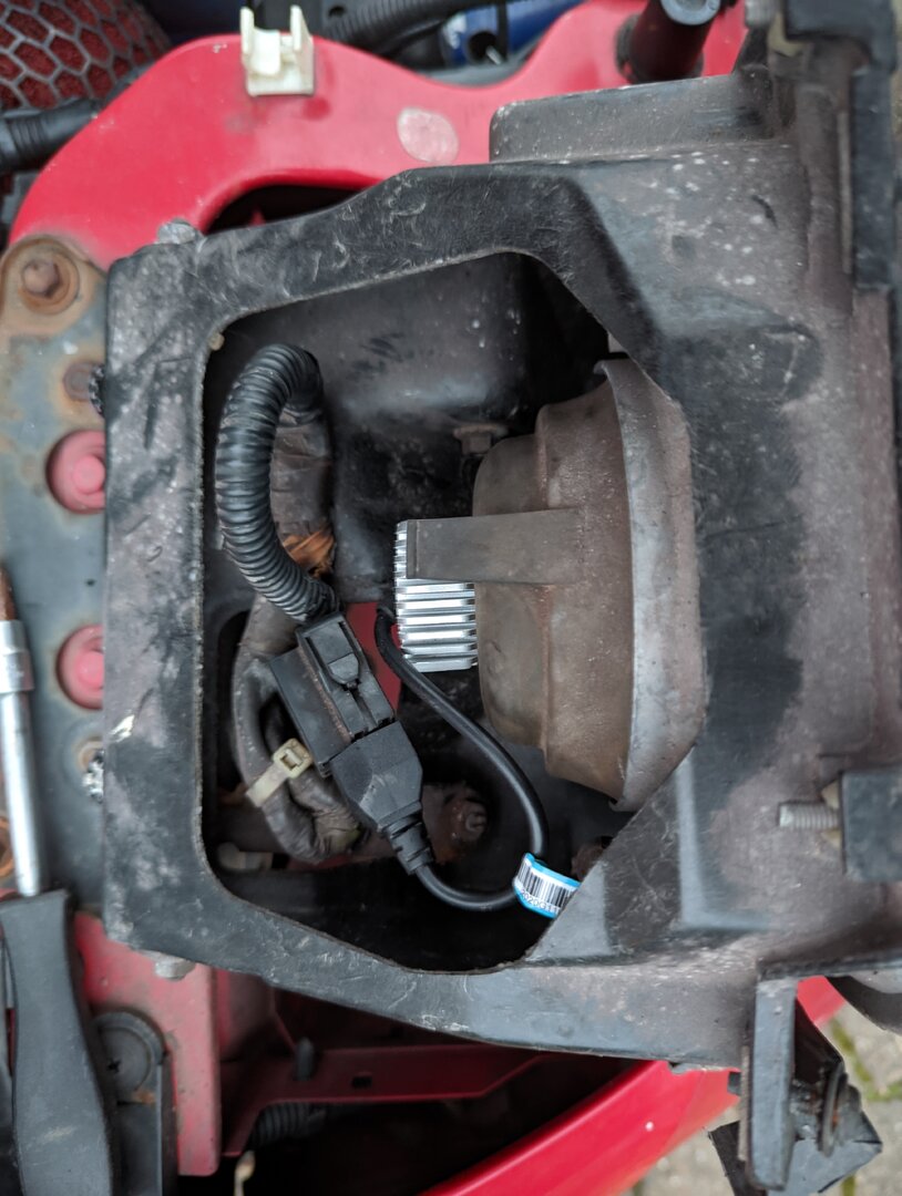

Next I finally fitted a set of LED headlights. This is probably the best £25 I've ever spent on a car lol, the difference is actually insane! Note: you have to trim the heatsink thing down and cut the rubber boot to get the new unit to fit, but otherwise a quick install.

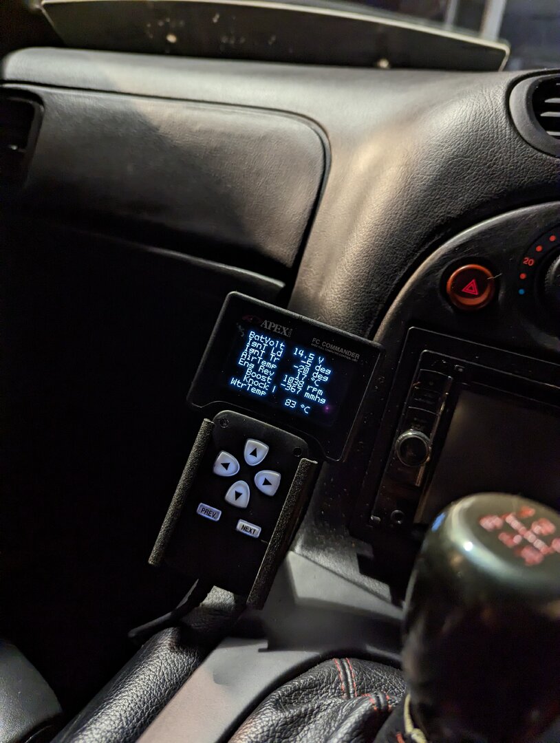

Late Jan/ Feb my PFC commander shat the bed, so I sent it off to FC-Hako in Australia for an LCD replacement. Unfortunately it was right around the Royal Mail cyber incident which lengthened the delivery time by quite a bit. Didn't end up getting the commander back until March - the longest the car has sat in my ownership! So much crisper now replaced though:

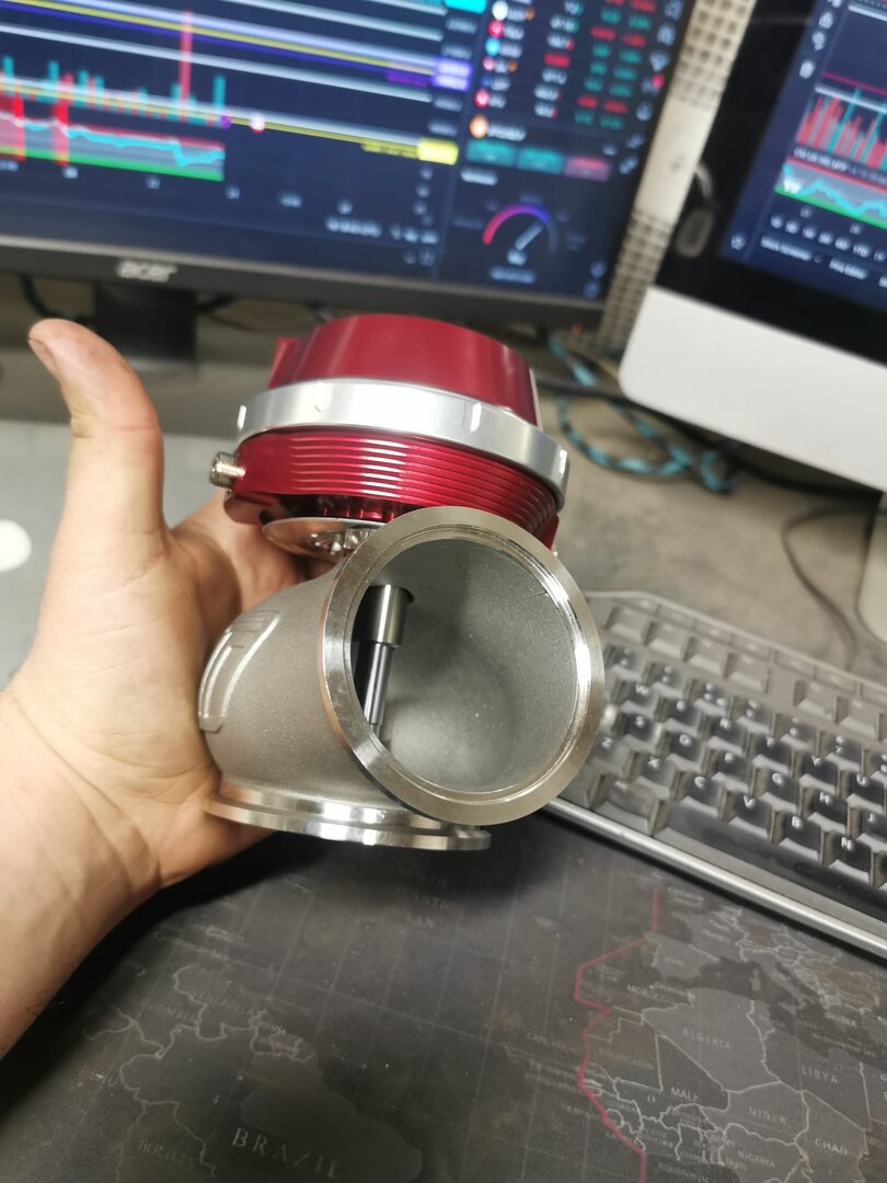

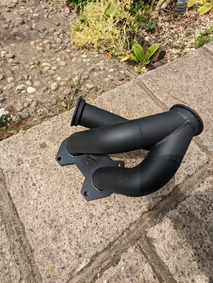

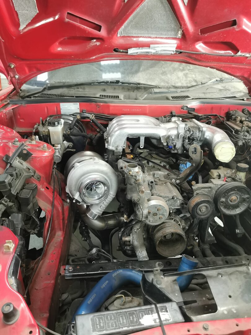

S.A.S started the turbo kit in March! I've nicked the pictures below from what he sent me (mocked up on his shop car):
Here's a link to his Insta with better pics of the manifold.

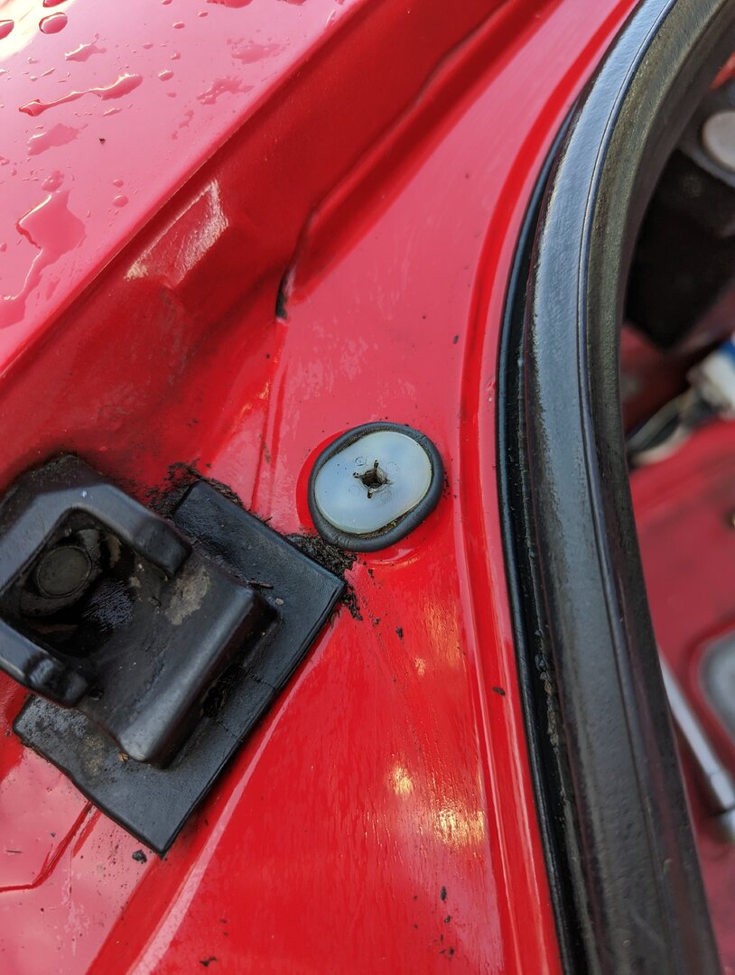

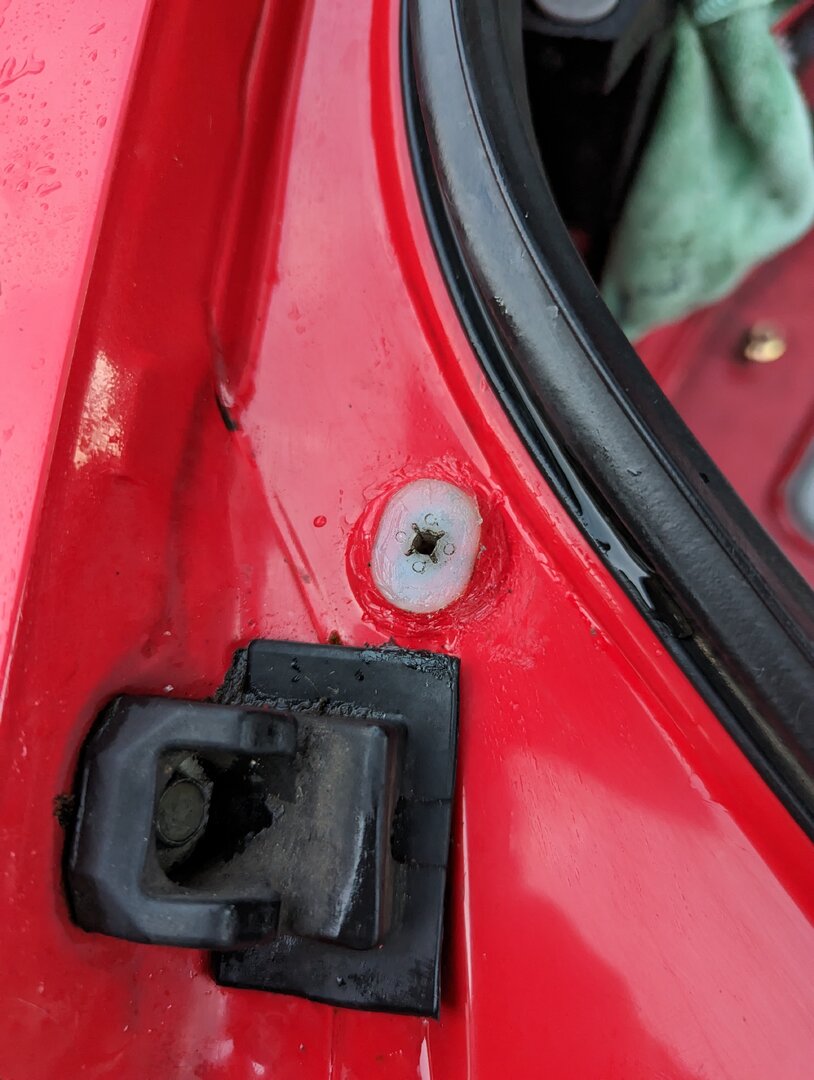

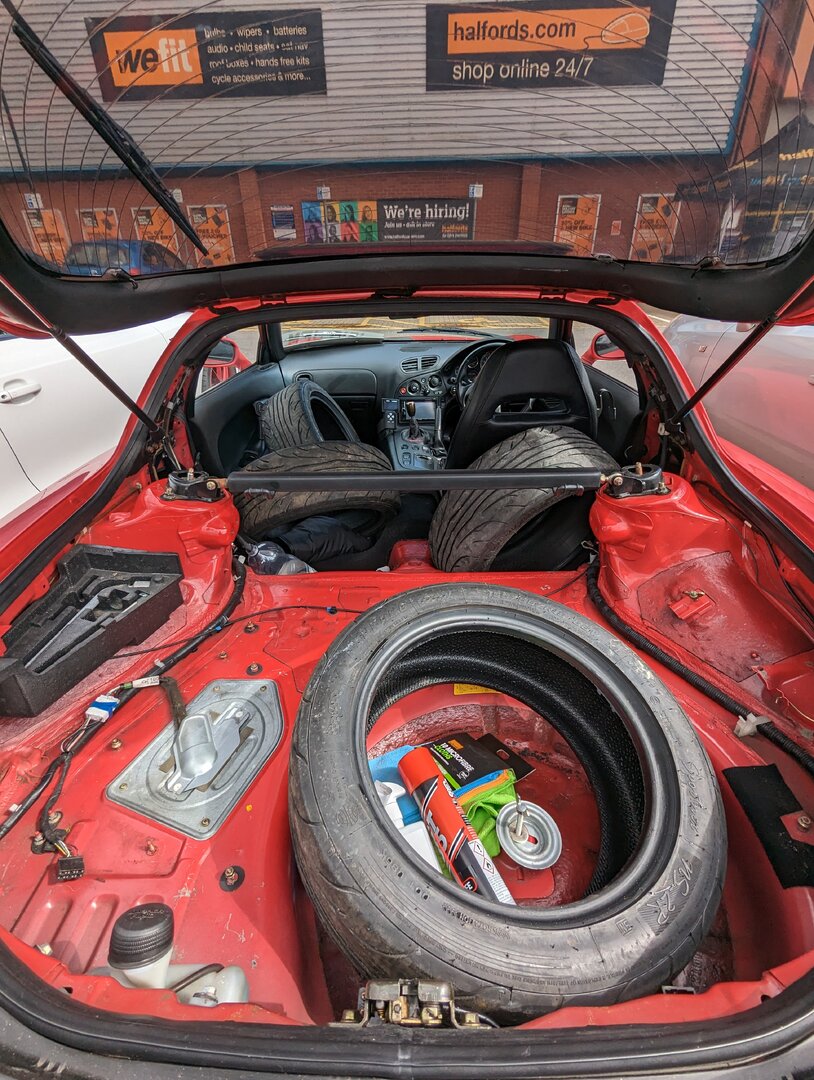

Aside from that, I noticed a puddle under my rear passenger seat, so out came the interior... Looked to be coming from either the spoiler or the plug under the triangle pieces at the rear - re-silicone'd and seems to be holding up for the moment.
Whipped off the spoiler too, taped up temporarily and the car is slowly turning into a 10-footer lol. Looks so much better though.

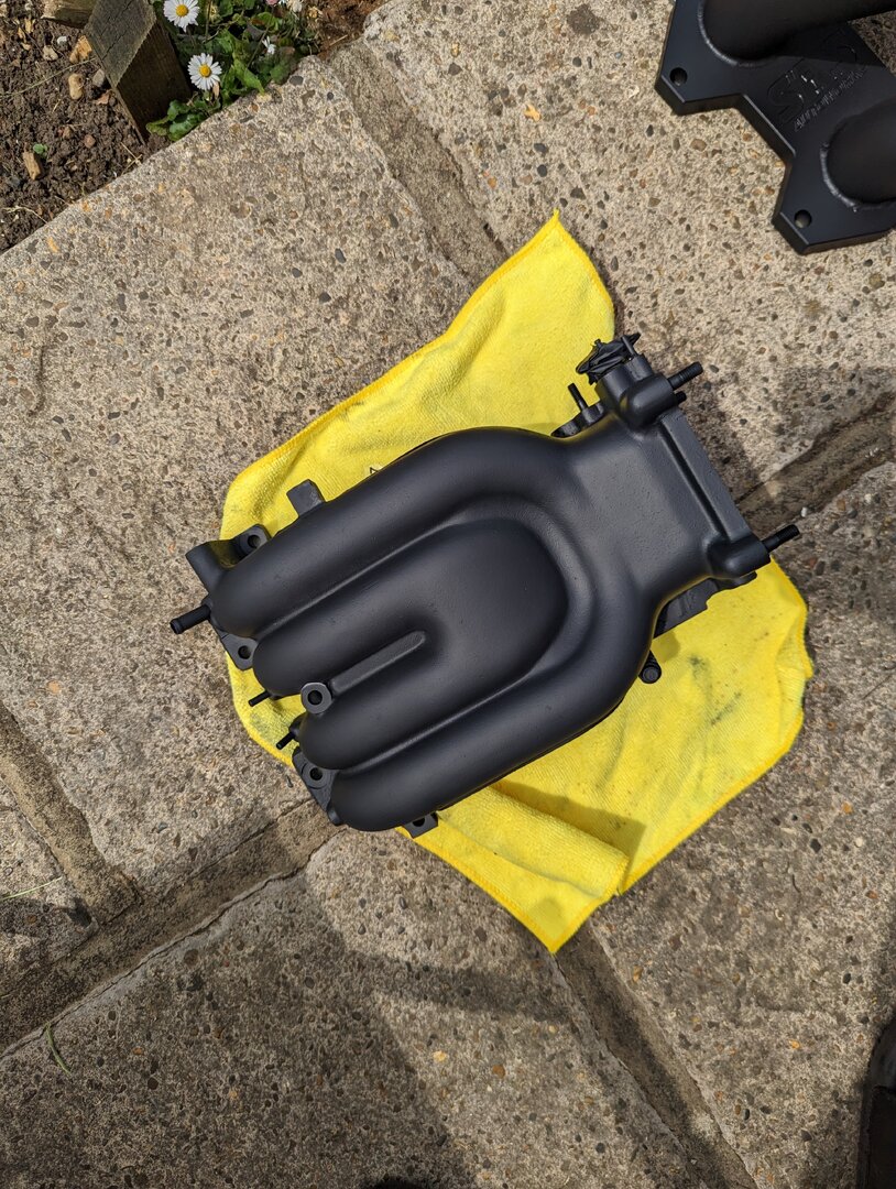

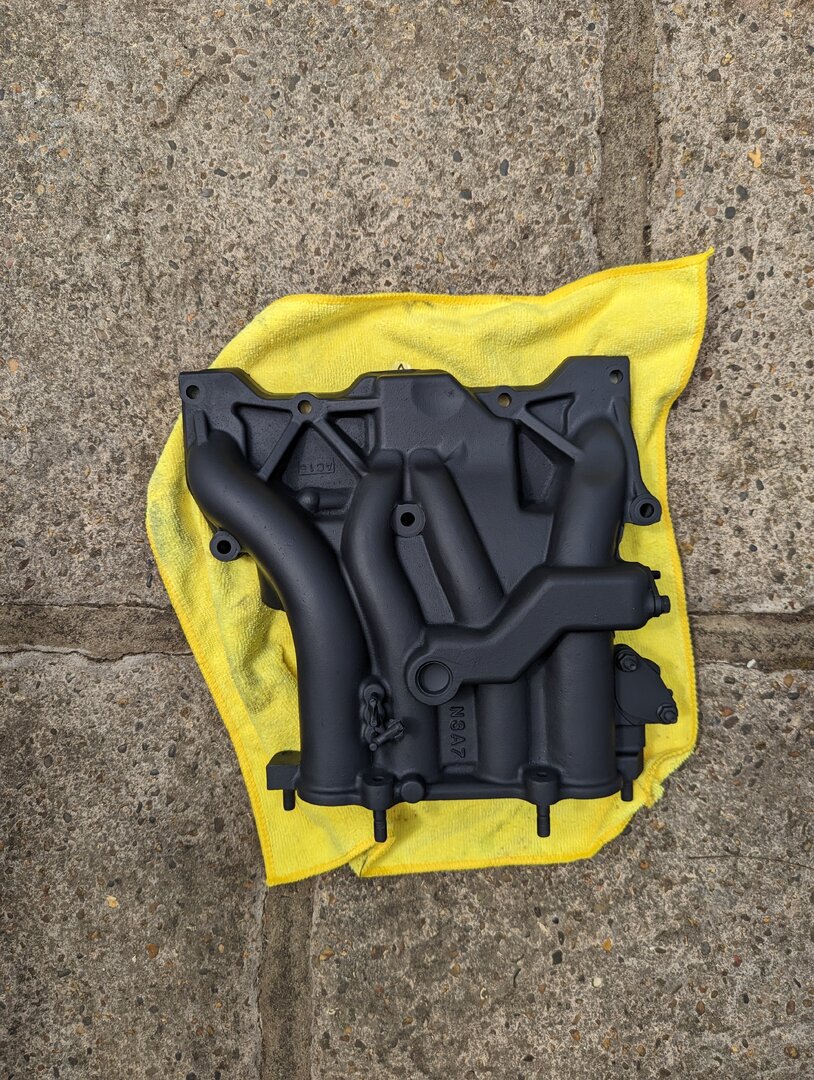

Just waiting on the downpipe/ finishing touches at present. Once that's done, I'll get the turbo and gate sent off to Thermomet for insulating, exhaust manifold, UIM, LIM & elbow off to be Cerakote'd and I'll get some DEI wrap for the DP. Was hoping to everything sorted for mapping in May, as I have a Ring trip in June - but timelines couldn't be met unfortunately.
Fingers crossed I can make the June mapping day as the car is pointless in the summer. Popped to Halfords on a mildly warm April day and intake temps were up to 67 degs after being parked up for 30 mins! :(

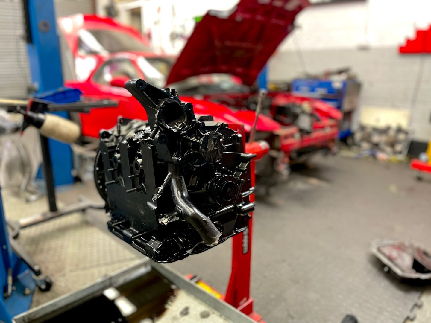

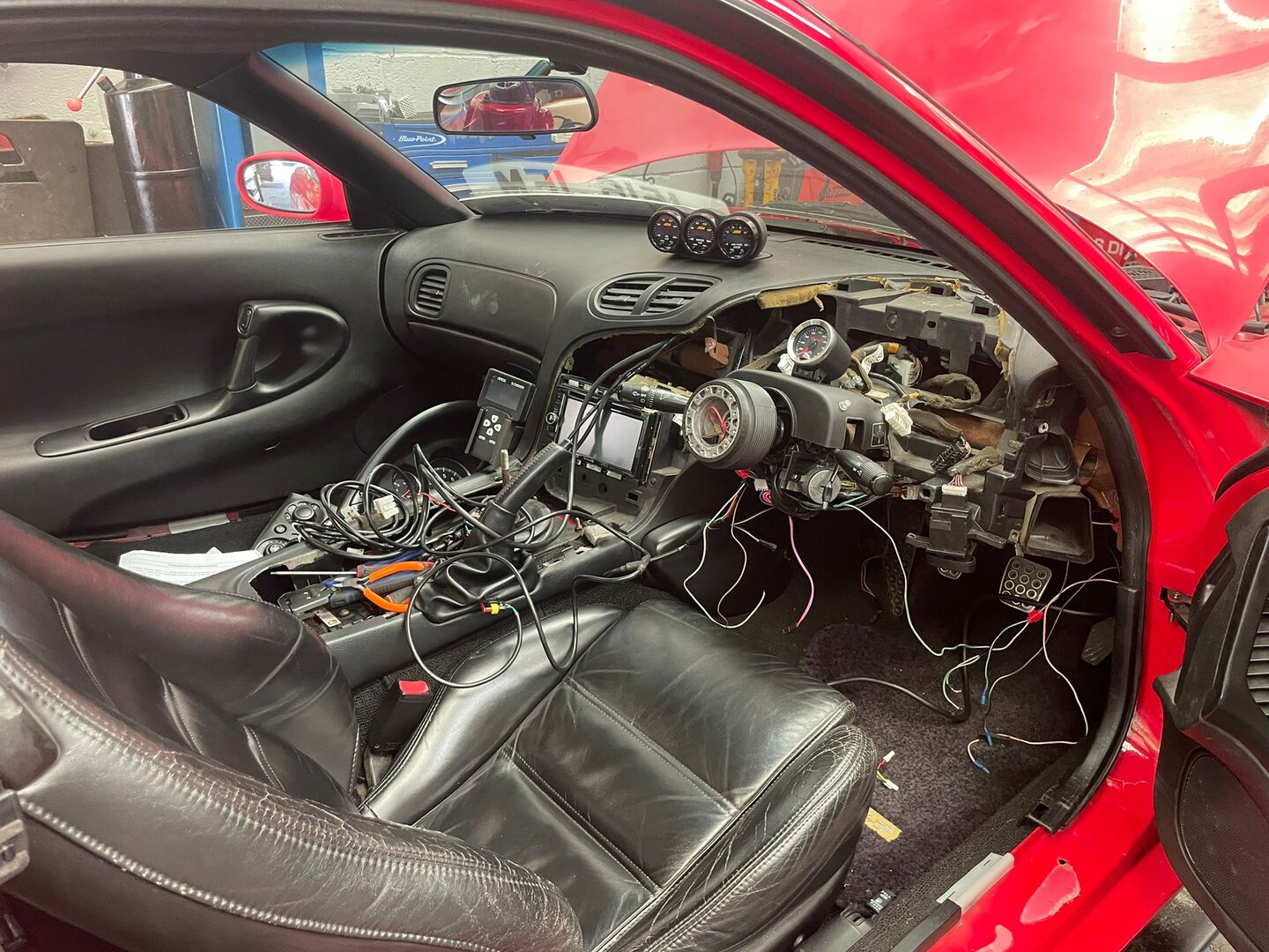

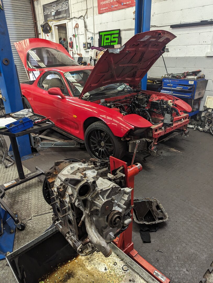

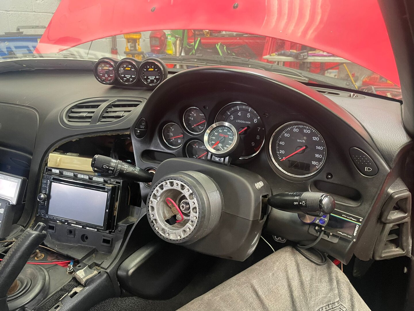

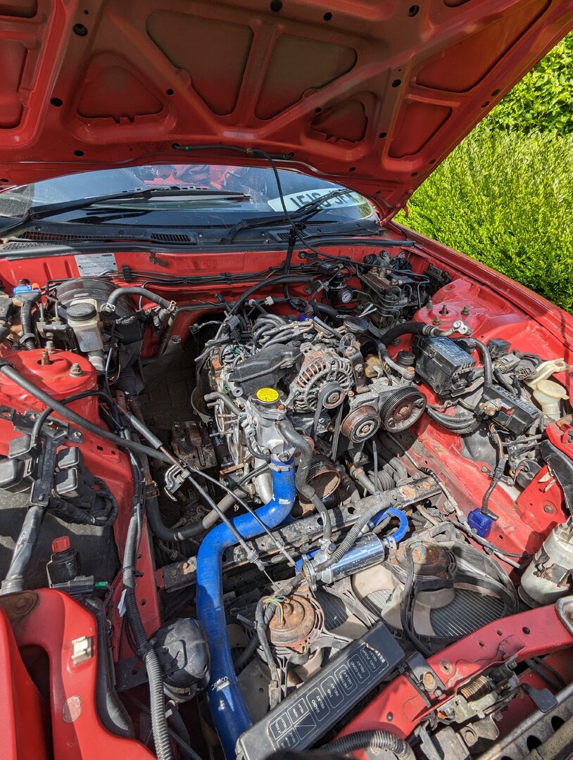

My mate Ash helped me strip the car down (by that I mean I watched him strip the car down lol). Was surprised at how small the block is with most of the bits removed. Also fitted a wiper delete which I think looks better than the wiper I never use - I'll eventually get the hatch holes welded up and painted, but that will wait as the whole car needs paint really!
