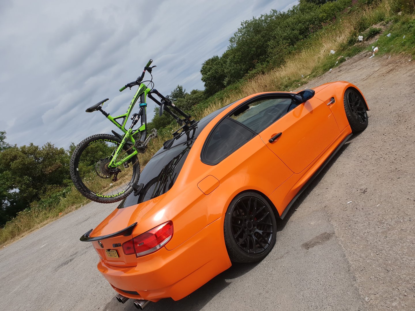

I haven't seen any pictures of one fitted to an FD yet, I don't want to be the first to trust a rear window with a not-entirely-cheap toy!
My mate rides with a guy who sticks an SB130 to the top of a new m3 with one, but he obviously has substantially more cash to risk than I do :D
