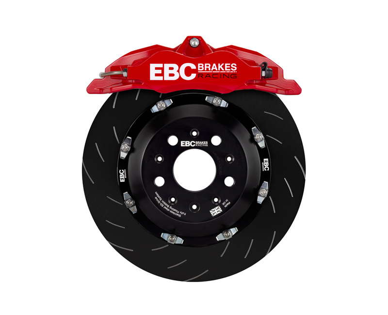

My car has gone in today for the first measure for a EBC big brake kit, for anyone interested these should be available in a few months, don't have any specs ATM but will post when i do all i do know is it will be calibers, pads, 2 piece discs, SS hoses and all hardware needed, similar to the kit linked below
Are they going to try and keep piston size close to the Stoptech kit for brake bias?
That seems to be a massive hot topic with BBK's and could do well if they can.
So i had a chat with them today when i collected the car.
Callipers will be 4 port with a smaller leading piston (same as the RS ones i have) same as shown above, but didn't have the piston specs to hand. Discs will be approx 350mm 2 piece
This thread has some excellent information on it. The Stoptech pistons 30/36mm staggered were the closest to stock brake bias.
Calipers – BC4102
Piston 1 – 41.2
Piston 2 – 38.1
No. of pistons - 4
Combined piston area mm2 – 4947
Equivalent Single Piston Diameter mm – 56.1

57.4cm250.3mm16.8mm38.1⌀/ 41.2⌀494756.1⌀28300355Radial15246.86M1057.70 (300mm disc)
55.60 (330mm disc)
54.00 (355mm disc)
2.58kg
