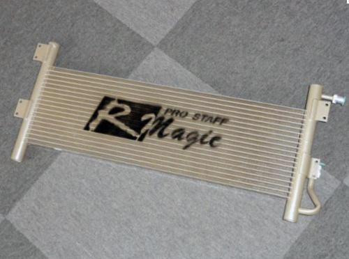

This looks like a cool unit, even if I have to find somewhere to put the drier. I'll probably end up just bolting it next to the battery. The ac lines are on the passenger side right?

The Rx8 unit is good if I can get some mounts for it because it doesnt mount the same, and I'm not fantstic at fabrication.
